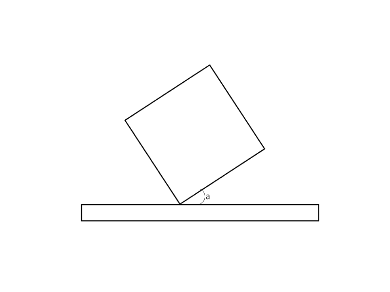

I have a question:
How to predict the post-impact motion of an 2D object, for example, a square, whether it will roll or bounce up, after hitting a flat surface. Given that we know the motion of inertia,angle of impact, pre-impact horizontal and vertical speed, angular velocity,? Thanks, the angle of impact a is shown below.

Regarding the more particular question of rolling vs bouncing, rolling by definition means that any contact points of a rolling body must be at zero velocity with whatever they are in contact with. Obviously, when a square's second vertex (per the original picture) collides with the surface, its velocity won't be zero, so the motion will be anything but rolling.
I have tried dropping it and sometimes it does not really bounce up but rather just drop down so the angle plays an important role. May be rolling is not the correct term to describe it.
