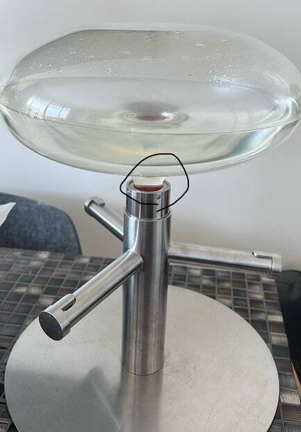

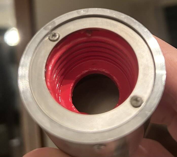

Hey guys,
It‘s been a few years since I had my last physics class so please be kind to me. I came here to ask you about a phenomenon I recently discovered in a design of mine.
The object in question is a stand with 3 arms, holding a water tank (see pic below).
All openings are pretty tightly closed and for a few hours there‘s no water leaking. But after a while, some pressure is building which pushes water out via the bottle screw (encircled in black). Another evidence of increased pressure is that when I let water out via one of the arms it would gush out if I wait for several hours. But soon after it would calm down and water flows smoothly again. Any ideas what‘s happening here?

If you fill it with cold water, that will warm over time, and the air will expand, building up pressure.

Thanks, I think you‘re on point. The pressure build up happens overnight when we turn our AC off and the room warms up. How could I potentially counter that? Small hole at the top of the glass bottle?

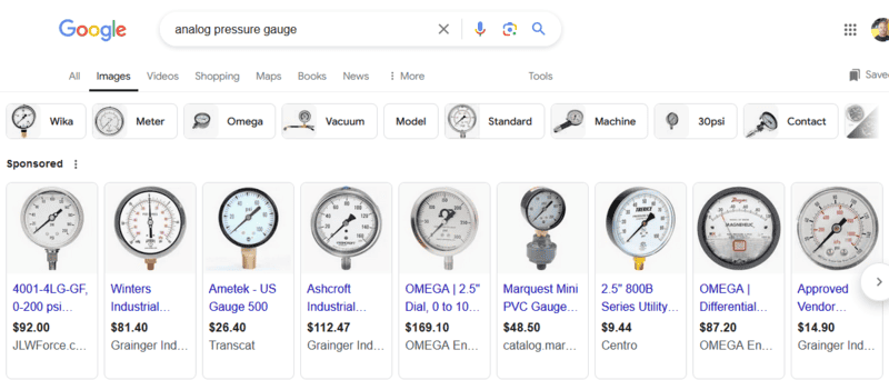

Does anyone know of an analog pressure sensor I could add somewhere?

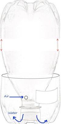

I don't know how this particular device works, but most water dispensers that use an inverted bottle work on the principle shown in the following diagram.
A certain amount of air replaces the volume of the limited amount of water that can flow out of the upper bottle when the level in the lower (open to atmosphere) recipient drops due to consumption.

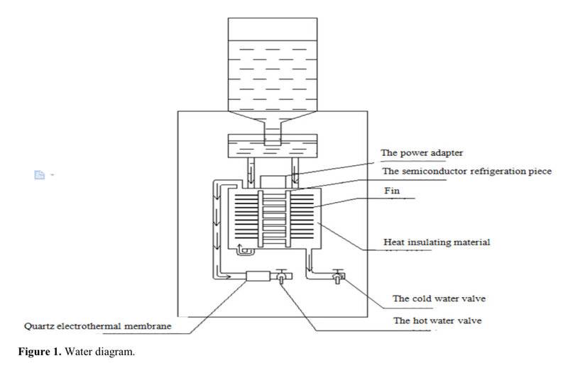

It looks to me that the diagram has been drawn wrongly. The lower container should surely be open topped so the diagram should show it. I looked at it for a while and it didn't make sense as it is. A clever mechanism, though but a bit of an extreme mod for the OP to contemplate.
The labelling is a bit confusing too. Why would they want 'Hot Water" (do they mean 'non-chilled'?) and what does the electrothermal membrane do? Do you have a link to that particular system?
@Lnewqban Thanks for the links. The basic system with a vent at the bottom is straightforward enough. Unlike the OP's version of drink dispenser, where there seems to be no capacity to balance the pressure so it appears to be pressurised. However, as I pointed out, the temperature variations it has to deal with mean that the pressure in there will be very low, even in a warm room. The joint between the bottle and the main unit should have no problem with those pressures. I feel sure that there's a fully working prototype somewhere that doesn't leak. Either that or the designer never tested the idea and forgot about excess pressure.
The fancy version with heating / cooling included is a bit suspect, despite the nice water system. Using a heat pump will improve energy efficiency but can it do the job in the home? The heat pump is only about 50W. For an 'instant' cool or hot drink, you'd need to wait a while (despite the hoped-for COP) . Instant hot water taps are rated in kW and desirable as they may be, they cost a disgustingly high amount and, as my (well off ) son says, they are fault prone and repairs are hard. That's not a fundamental objection to the idea but, in between the designers and the users, there are a host of marketing and sales people who are milking the idea. Hot water pipes all over the house are a really daft idea but most of us have no affordable alternative.

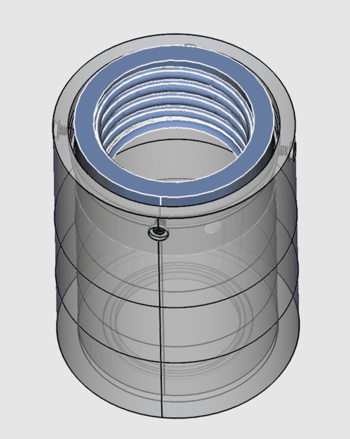

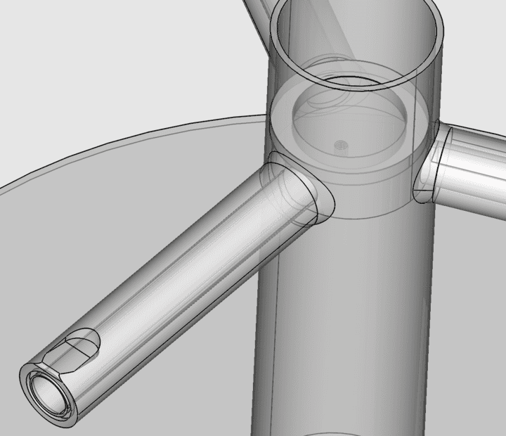

I think it‘s a faulty GL32 cap which lets the water through. Below are some more pictures to illustrate the design.
I'm a lazy devil, basically and I looked for the simplest solution. After all, an upside down soda bottle doesn't leak, does it? And the thread material should be better quality than a single use pop bottle.
Isn't the gap between the top metal retainer and the red cap, as well as the 40~45 mm annular gap between the red cap and the machined metal housing, the path for air to get in each time water is let out?
If so, calcium deposits may have clogged that and using some vinegar may be the easiest solution.
May I ask about the function of that small threaded hole (circled in red)?
Its a M3 threaded hole where the pin goes that’s needed to let water from the bottle into the arms.
