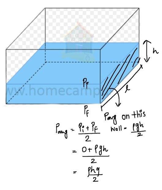

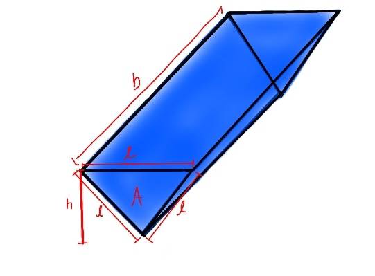

What is the average pressure on the triangular wall by the liquid ?
given :
density of liquid p
gravitational acc is g
For Dimensions of container please check the figure(i have attached please Check)
.( Assume Patm = 0)
Pressure at a point, x distance below the free surface of the liquid = pgx
I have just started this topic so i Don't have much clearity about it .
In our school it was tought that
Pavg = (Pi + Pf)/2 ...(i)
If we have a cuboidal shape container then it should be pgh/2 ryt ?
Hand-drawn sketch of a water-filled rectangular tank with depth h and length l, showing a side wall with P_avg = (P_i + P_F)/2 = (0 + rho g h)/2 = rho g h / 2.
But also Pavg = Ftotal on the wall /A ...(ii)
= (pgh²l/2)/lh = pgh/2
It it was a triangular wall then Pavg comes different
Using (i) Pavg = pgh/2
(ii) Pavg = pgh/3
Which is correct ? 😓
Using
  • Red-annotated blue 3D sketch of a triangular prism-shaped tank with base edges labelled l, slant side b, height h and base area A.

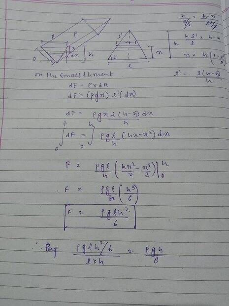

The average pressure on a flat surface is the total force on the surface divided by total area of the surface. What is the total area of the surface that you are interested in? Do you know how to determine the total pressure force on this surface?
Yes got it now
I was finding Pavg on the triangular wall
What I could do is this -
Handwritten notes on lined paper: a tilted container with a triangular side wall, an element of depth dx at depth x, and the integral of dF = pgx l'(dx) with l' = l(h-x)/h, giving F = pglh^2/6 and P_avg = pgh/6.
There's a correction in the image
Pavg = (pglh^2/6)/(lh/2) = pgh/3
now is it correct ?
