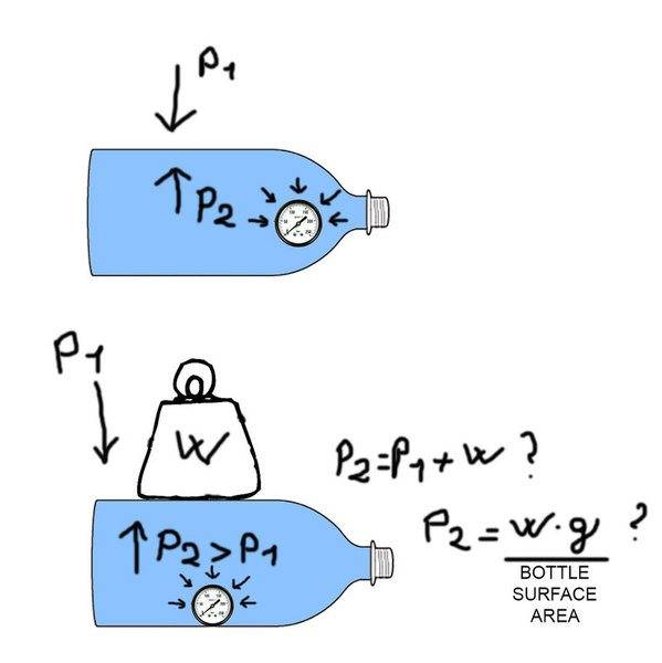

I (perhaps wrongly) assumed that pressure inside a bottle with a weight sitting on top should be higher than pressure inside a bottle with no weight on?
Here's a sketch I did
The pressure is higher, but it isn't the total surface area that supports the weight it is just the contact area that supports the weight.
I can't get my head around this (or maybe I just explained my question poorly): if one considers only the weight-bearing area as you suggest, wouldn't a smaller supporting area yield a higher pressure even if weight stays the same, something which doesn't make sense to me since I guess that pressure experienced by an object inside the bottle would still be the same as long as the weights are equal?

Alfreds9 said:
I can't get my head around this (or maybe I just explained my question poorly): if one considers only the weight-bearing area as you suggest, wouldn't a smaller supporting area yield a higher pressure even if weight stays the same...
That is exactly what happens. Think about the car tire example given above. You can inflate your car tires to any pressure until they pop, but the weight of your car doesn't change.

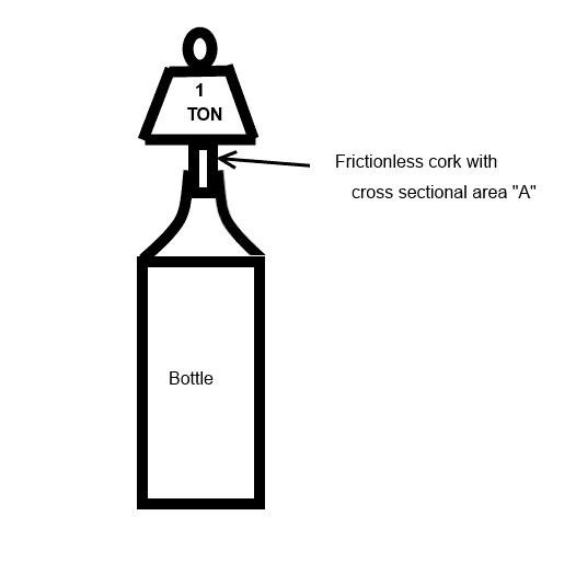

Perhaps this version of the problem makes it easier to understand. The pressure in the bottle is the weight divided by the cross sectional area of the cork.

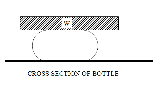

Referring to post #11, if the total perimeter is ##\pi D## and the length of the cylinder is L, then the width of the footprint is ##\frac{W}{pL}## on both the weight side and the floor side, where p is the inside gauge pressure. So the combined length of the 2 sidewalls is ##\pi D-\frac{2W}{pL}##. The sidewalls are circular, so the height of the weight above the floor is ##D-\frac{2W}{\pi pL}##.
My concern with this example is that the example has the potential to solidify the erroneous assumption that the cross sectional area would be fixed regardless of the mass sitting on the cork. With the bottle laying on its side, both the pressure and cross sectional area change with the mass and the pressure can also change independent of the other two (the other two being dependent).
