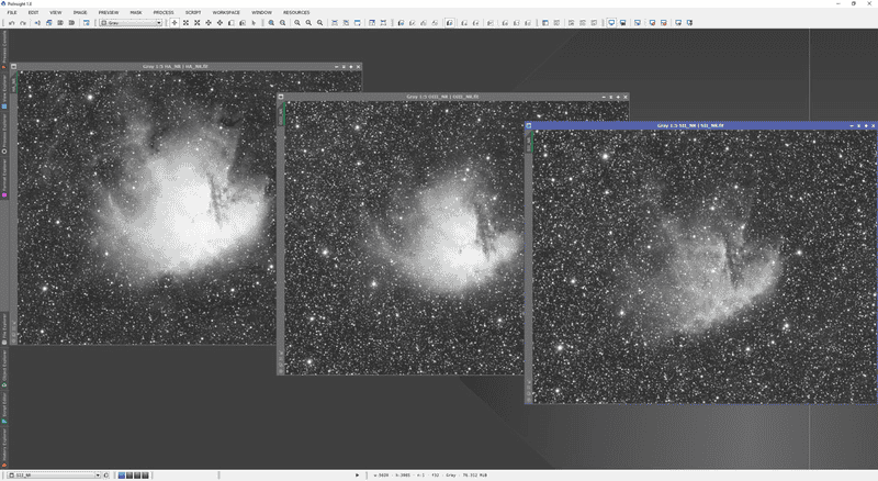

Humans are pretty good at interpreting full colour images. It's kind of our thing.Now, it's true that, if we want to examine specific sets of data individually, we might want to break those out:
Hydrogen-Alpha (left), Oxygen-III (middle) and Sulphur-II (right):
https://www.lightvortexastronomy.com/tutorial-narrowband-hubble-palette.html
