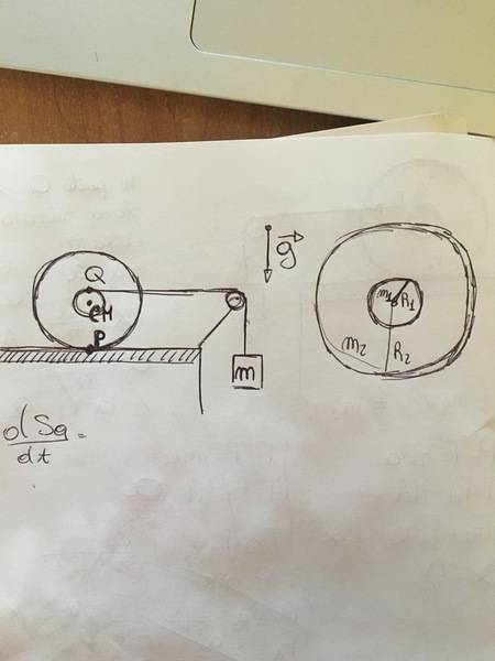

A solid body consisting in two concentric disks of masses m1, m2 and radius r1<r2 is linked through a ideal rope to a mass m which falls down with a certain acceleration. The solid body moves of pure rolling.
Find the acceleration a of the mass.
Hand-drawn sketch of a physics setup: a double disk of radii R1 and R2 with masses m1 and m2 rolls on a horizontal surface, a rope runs over a pulley to hanging mass m, with point P at the contact and point Q on the rope, and gravity g shown pointing down.
P-T=m*a
T-F=(m1+m2)*A
I=1/2*m1*r1^2+1/2*m2*r2^2
T*r1+F*r2=I*alpha
SQ=w*r1+Scm or Sq=w*r1
a=aQ=alpha*r1+A or a=aQ=alpha*r1
A=alpha*r2
The mass m is subject to its weight force P=m*g and the tension T of the rope so:
P-T=m*a
T-F=(m1+m2)*a
On the solid body the tension and the grip of the floor (F) act:
T-F=(m1+m2)*A
I chose the center of mass (cm) as the pole of momentum of forces:
T*r1+F*r2=I*alpha
now I tried to find a relation between a and alpha: the acceleration and the speed of the piont Q has to be equal to the speed and the acceleration of the mass because the rope can't extend. So SQ=w*r1+Scm and a=aQ=alpha*r1+A (indeed I don't know if SQ=w*r1+Scm or simply SQ=w*r1 in fact, in the solution of the problem I found that SQ=w*(r1+r2) but it has chosen the point P as pole for the momentum on the forces which ita speed is istant by istant naught). Since the body rolls without slither, the acceleration A of the center of mass and alpha must satisfy the condition A=alpha*r2.
I solved the sistem of equations (I tried both the equations for the speed) but in any case my solution was wrong. I hope you can help me.
Thanks a lot
  • Hand-drawn sketch of a physics setup: a double disk of radii R1 and R2 with masses m1 and m2 rolls on a horizontal surface, a rope runs over a pulley to hanging mass m, with point P at the contact and point Q on the rope, and gravity g shown pointing down.
Hello @MathError, welcome to Physics Forums!
:welcome:
I haven't worked through the solution yet myself for these reasons: (A) there are some ambiguities in the problem statement and (B) once you get the ambiguities addressed you need to show more of your work.
Ambiguity (i):
Does disk 2 have a hole in the center allowing disk 1 to slide through (before they are attached together)? Or, is disk 2 completely solid, with disk 1 pasted on at its side?
Although there might be special cases where it doesn't matter (given the densities of the disks, etc.), the distinction does matter for the more general case.
For what it's worth, your initial attempt treated disk 1 being pasted onto the side of disk 2 (i.e., both are solid disks without holes). I just want to make sure that you are using the correct assumption in your approach.
Ambiguity (ii):
Are we supposed to find the linear acceleration a of the hanging mass or the cm of the rolling mass? It's not quite clear which mass is being discussed where.
The same is true in your attempted solution. Your attempt has the variable "A" in it in a few places, but it's not always clear to me which acceleration it refers to.
It would be helpful to everyone involved if you could define your variables more clearly.

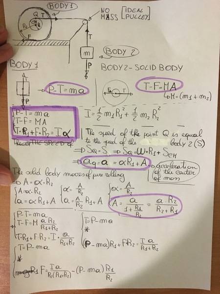

Hello, thanks for the answers, I'm sorry for the abiguities in the text so I'll try to be more clear.
The two disks are completely solid in fact in the section "relevant equations" I wrote the equation for the moment of inertia which is I=1/2*m1*r1^2+1/2*m2*r2^2.
The variable a rapresents the acceleration of the mass which is falling down while A is the acceleration of the center of mass of the solid body and alpha is the angular acceleration of the solid body.
I didn't write all my solution because I thought it would have made the text even harder to understand. So I reported all the equations I worked out and I tried to explain my doubts finding the relation betwenn a,A and alpha, in fact the solution writes SQ=w*(r1+r2), so a=alpha*(r1+r2), A=alpha*r2, A=a*r2/(r1+r2). However it assumed the point P, as pole for the momentum of forces which has zero speed. Instead I tried to solve the problem from the center of mass but I think I made some mistakes calculating the momentum of forces or finding the relation between a,A, and alpha as I wrote in this section of the text.
MathError said:
T*r1+F*r2=I*alpha
Maybe, but I could not identify any in your post, so you will need to write out all your steps.

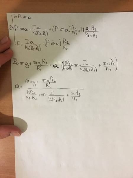

Handwritten physics solution with a sketch of a solid cylinder body on a rough incline, a string over an ideal pulley to a hanging mass m, labelled Body 1 and Body 2, with equations for T, F, R, I and the rolling condition, some boxed in purple.
Handwritten derivation on lined paper: T = P - ma, then P - ma - Ia/(R2(R1+R2)) + (P - ma)R1/R2 = H a R2/(R1+R2), then a formula for a = (mg + mgR1/R2) divided by (HR2/(R1+R2) + m + I/(R2(R1+R2)) + mR1/R2).
  • Handwritten physics solution with a sketch of a solid cylinder body on a rough incline, a string over an ideal pulley to a hanging mass m, labelled Body 1 and Body 2, with equations for T, F, R, I and the rolling condition, some boxed in purple.
  • Handwritten derivation on lined paper: T = P - ma, then P - ma - Ia/(R2(R1+R2)) + (P - ma)R1/R2 = H a R2/(R1+R2), then a formula for a = (mg + mgR1/R2) divided by (HR2/(R1+R2) + m + I/(R2(R1+R2)) + mR1/R2).
I'm sorry, I checked one more time the results, fixing the values, and they agree, so I made some algebric mistaskes.
However I want to make sure I understand the problem: if I didn't add the speed of the CM in the equation SQ=w*r1+Scm, wouldn't I consider the traslation of the CM? And why, using P as pole for the momentum, didn't it add CM's speed? (Maybe because it has no speed but I'm not sure)
Why would you not add it?
I don't understand what you are suggesting in terms of equations.
In general, you can consider the motion of a rigid body as the sum of a translation of and a rotation about a point fixed within the body. The two commonest choices are the mass centre and the instantaneous centre of rotation. If you choose the second then there is, by definition, no translation, and the entire motion can be expressed as a rotation about that point.
For a rolling disc or sphere, the point of contact is the instantaneous centre of rotation.
For what it is worth, this is my solution:
We can eliminate the pulley, making the string go horizontally all the way to the mass, with mg acting horizontally on it. Now we can express everything in terms of torques and moments of inertia about P:
##mg(r_1+r_2)=\alpha(m(r_1+r_2)^2+Mr_2^2+I)##
