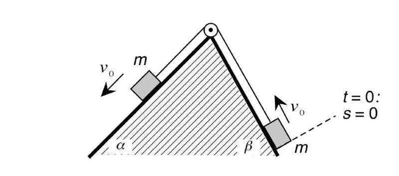

Two identical masses are connected with a rope and are gliding without any friction. Situation given in the picture:
Diagram of two equal masses m on opposite sides of a frictionless wedge over a pulley, angles alpha and beta at the base, initial velocity v0 marked on each mass, and s = 0 at t = 0 marked at the right mass.
Determine after which distance "s" they stop if we have s=0 at t=0 with starting velocity ##v_0##
Given:
##\alpha## and ##\beta## with ##\alpha < \beta##
##v_0##, ##m ##,##g ##
No friction
I guess they mean when the two masses stop for the very first time, since both masses are equal and ##\beta## is bigger than alpha, they will start gliding towards the right side.
Say the left mass is m1 and the right mass m2 and say ##v_0## is positive.
Then:
(1)##g*m_1*sin(\alpha)-F_{rope}=m1*a##
(2)##-g*m_2*sin(\beta)+F_{rope}=m2*a##
Solving 2nd equation for F and using the fact bot masses are equal, we get in the first equation:
##g*m*sin(\alpha)-m*a-g*m*sin(\beta)=m*a##
##a=\frac{g}{2}*(sin(\alpha)-sin(\beta))##
Now how do I continue from here? I tried to use integrate twice ##s = \frac{gt^2}{4}*(sin(\alpha)-sin(\beta))+v_0*t+0 ## (##s_0=0##) but then how the get rid of the time?

Are you familiar with the equations of motion for constant acceleration? Specifically, the one V = V0 + a*t should help you. Find the time at which V = 0.

You have calculated a constant acceleration. Can you solve the problem without introducing an unknown time variable?

There is another equation you could use. But, if you don't know it you could follow the advice of @scottdave to calculate and eliminate ##t## from your equation.
You seem to me to have done the hard part of the problem already.

I get ##s=\frac{v_0^2}{2a}+\frac{v_0^2}{a}##
Replacing my a gives me:
##s=\frac{1}{2}*\frac{v_0}{\frac{g*(sin(\alpha)-sin(\beta)}{2}}+\frac{2*v_0}{g*(sin(\alpha)-sin(\beta)}##
##s=\frac{3*v_0}{g*(sin(\alpha)-sin(\beta)}##
which is wrong by the factor 3.
I'm not sure how you got that equation.
Hint: There's another SUVAT equation that involves initial and final velocities, acceleration, and distance. No time involved.
