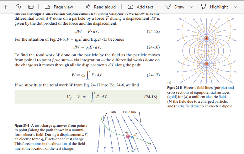

haruspex said:
No. How does one find a potential difference given the electric fields?
I have said that base on this page of my book. Is it false ?!
E is 0 so DeltaV is 0.
You have to do the integral all the way from x=-∞ to x=+∞. The field is not zero for some of that.
