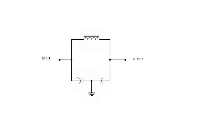

I have built a LC parallel tank circuit, and I am having a problem with it. I have a ground that is placed between two polarized capacitors in series. With the positive leads grounded. And an output on the opposite of the input. The problem I am having is when I connect the ground the input signal shorts out to the ground, and I get no signal on the output. And when I disconnect the ground connection the circuit doesn't filter out the unwanted frequencies.
Can someone please let me know what I'm doing wrong.

Could you please post a sketch or schematic? You are trying to make a bandpass filter with the parallel LC circuit? It doesn't sound like you are using the polar capacitors correctly, for one thing. What voltages (DC and AC) comprise your input signal?
The signal is AC. Also I don't know how to post a sketch. I have one. Can someone tell me how to post it.
The pic helps, thanks.
That's not any filter topology that I'm familiar with. Where did you find it?
More typically, you will use either a "T" or a "PI" filter configuration. For a T configuration, you would put two inductors in series, with a capacitor to ground between them, and the left end of the top of the T is the input, and the right end is the output. You can also skip the right inductor, and just have an LC lowpass filter.
If you have capacitors across the top of the T, with an inductor to ground in the middle, that has a different transfer function compared to the first T I described. BTW, the output impedance of the "input" signal, and the input impedance of the circuit connected to the "output" end, both influence the transfer characteristic of the T or PI filters.
If you mean to have a parallel LC resonant circuit as part of a simple filter, you could ut the L and C in parallel (drawn vertically) as the vertical part of a T filter, and use resistors for the input and output coupling to it (as the left and right sides of the top of the T).

Oh, and showing the caps as polarized is also an error, unless your signal has a negative DC bias voltage greater than its peak amplitude. You should be using unpolarized capacitors, unless a DC bias is an explicit part of the circuit.
the diagram is a resonant tank circuit. basically the same as an old fashion radio tuner. Meant to discard unwanted frequencies to the ground and allow the resonant frequency to pass. So should I be using two non-polar capacitors in series with a ground?
Idea04 filter is set up for a negative voltage DC filter for DC with ripple. Use either a resistor or inductance for input to this filter.
The effect you are getting is quite normal.
That is a Pi network and needs to be near resonance for it to do anything useful.
If you are using polarized capacitors, they are probably too big for RF applications.
Polarized capacitors are usually more than 1uF which is far too big for RF.
They also don't work well at RF. The input capacitance in your network is probably almost a short circuit at RF so that is why your signal vanishes.
Pi networks are used for impedance matching and they have to have exact values of inductance and capacitance to work properly.
