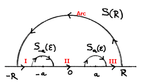

The integral of the contour C is 0, as no singularities can be found inside C.
<br /> \oint_C = 0 = \int_A + \int_B + \int_C + \int_D<br />
I want to demonstrate that \int_D tends to 0 as R tends to infinite. For doing so I tried the following parametrization and check
the limit when R tends to 0, but couldn't reach something showing that the limit is 0.
<br /> z = Re^{it}, t=0...\pi <br />
<br /> dz = iRe^{it} dt <br />
I also want to demonstrate that \int_B tends to 0 as R tends to infinite, but can't see how to do it neither. Visually I can see
that when R tends to 0 the integrals over A and C become so big that the integral over B is negligible (zero).
Questions:
How could I demonstrate that those two integrals tend to to 0 (which I think they do) ?
Thanks in advance...

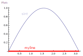

Thanks again for your suggestion. OK, taking the first part:
<br /> \lim_{R\to\infty} \int_D \frac{e^{3iz}}{z^3}dz=0,\quad z=Re^{it},\quad 0\leq t\leq \pi<br />
I think we can do this:
<br /> \left| \int_{0}^{\pi} \frac{e^{3i(Re^{it})}iRe^{it} }{R^3e^{3it}} dt \right|\leq \frac{1}{R^3} \int_{0}^{\pi} \left| e^{3iR(cost +isint)} \right| dt = \frac{1}{R^3} \int_{0}^{\pi} \left| e^{3iRcost - 3Rsint)} \right| dt \leq \frac{1}{R^3} \int_{0}^{\pi} e^{-3R(sint)} dt \leq \frac{1}{R^3} \int_{0}^{\pi} e^{-3R(myline)} dt<br />
I choose myline as y=0 so that sint > myline according to this pic:
And then,
<br /> \frac{1}{R^3} \int_{0}^{\pi} e^{-3R(myline)} dt = \frac{1}{R^3} \int_{0}^{\pi} e^{-3R(0)} dt = \frac{1}{R^3} \int_{0}^{\pi} dt = \frac{\pi}{R^{3}}<br />
and we can say that when R tends to infinite, it becomes 0. Is it ok like this?

That should be:
\lim_{R\to\infty}\frac{1}{R^2}\int_0^{\pi} e^{-3R\sin(t)}dt
But it's not necessary to use that myline approach here. Don't recall if it was in the other problem. Just note that in the range 0\leq t\leq \pi, we have \left|e^{-3R\sin(t)}\right|&lt;=1 so that whole integral is less than the constant \pi and so:
\lim_{R\to\infty}\frac{1}{R^2}\int_0^{\pi} e^{-3R\sin(t)}dt\leq \lim_{R\to\infty}\frac{1}{R^2}\pi=0.
Now you can do the same with the expression e^{iz}, and 2 and conclude the integral of the entire expression goes to zero as well.

I haven't worked it out yet. Not sure how to in fact. Maybe others can help too. But looks to me we need a different approach.
Note if you try and just look at the part:
\frac{e^{3iz}}{z^3},
as \rho\to 0, that expression tend to infinity because of the rho in the denominator. However it may be that:
\lim_{\rho\to 0} \int_{\pi}^0 \frac{e^{3iz}-3e^{iz}+2}{z^3}dz\overset{?}{\to}\frac{0}{0}
which means you'll need to take the limit of the entire expression but I'm not sure. Maybe need to try the myline approach on it then take the limit. And one of the most important things I can suggest to you is to just try things and learn to recognize that often, the things you initially try don't work but sometimes lead you to the route that does. :)
Note that part B) will not go to zero, it will be minus -1/2 times 2 pi i times times the residue. This is just the formula mentioned at the start of the problem. What then happens is that you decided to exclue the pole from the contour, but you now get its resudue back multipoled by minus -1/2. If you bring this to the other side, you see that you got hapf the residue of the pole.
Had you included the pole, the contour integral would have picked up the contribution from the residue. However, you would now have had half the residue which you would have had to move to the other side. So, either way, you end up with half the residue.
So, you're essentially rederiving Plemelj's formula: if you are lazy you can just let the contour run through a pole and define the integral as a suitably defined principal part, instead of bothering about making a small detour and letting the radius go to zero. You the residue then counts for half. In general if the contour interects the pole and makes an angle on the pole, then you need to replace 2 pi i times the residue by the i times the angle times the residue.

<br /> \int_{B} f(z)dz = \lim_{\rho\to 0} \int_{B} f(z)dz = i (\theta_{2}-\theta_{1}) Res(f(0)) = i \pi Res(f(0))<br />
theta1 should be pi and theta2 should be zero. Because you start the small circle at theta1 = pi and it ends at theta2 = 0.
So, you get minus pi i times the residue, which brought to the other side of the equation yields that the sum of the other parts of the contour integral is pi i times the residue. Part A and C together while letting rho shrink to zero is how you can define "moving through the pole". You compute that by adding the half circle B connecting A and C so that you get a closed contour, the integral over which is zero, and then evaluating B separately in the limit of rho to zero.
So, you see that if the contour "moves through a pole", as defined above, in a straght line, you get a contribution of pi i times the residue instead of 2 pi i, so the residue counts for 1/2 relative to what it would be if the pole were inside the contour. This a special case of Plemej's formula.

By the way, I just have a last question regarding contour integrals problems: in this problem we used a great formula which tells us that the integral when rho->0 (the pole at z=0) is (pi*i*Residue). This formula also appears in Serge Lang's Complex Analysis Book.
However, according to another book, if rho->a and a is not zero, for example, in the following image:
we have a different formula that tells us that the integral when rho-> a is pi*Residue, so we can do the following:
<br /> \int_C = \int_{I} + \int_{S_{-a}(E)} + \int_{II} + \int_{S_{a}(E)} + \int_{III} + \int_{Arc} = <br />
<br /> = \int_{-R}^{0} + \int_{S_{-a}(E)} + \int_{S_{a}(E)} + \int_{0}^{R} + \int_{Arc} = <br />
when E tends to a and -a, and R tends to infty we get:
<br /> = \int_{-\infty}^{0} + \pi Res(z=-a) + \pi Res(z=a) + \int_{0}^{\infty} + 0<br />
The question is in the second step: is it ok to ignore II and join in two integrals ? (the one from -R to 0 and the one of 0 to R) Or we should use the three integrals I, II, III separately?
Thanks again!
The integral around a simple pole as the radius goes to zero is simply \theta i r
where r is the residue and \theta is the arc length of the contour and is positive or negative depending if it's in the positive or reverse orientation.
Thanks again!
No. You have to go from -R to -a, then -a to a, then a to R.
Why? In the real line I can see 5 diferent integrals...

That's not correct. We showed above that these two integrals combined into a single integral from 0 to infinity so no 2. Sides, I checked it against Mathematica and it's 3pi/8.
Ok, you're right, the other two half-circle contours also.
Oh! You're completely right, I was mistakenly thinking about the fact of joining the two half integrals as well...
Thanks! OK, so this should be right:
\int_C = \int_{-R}^{-a-\rho} + \int_{S_{-a}} + \int_{-a+\rho}^{0} + \int_{0}^{a-\rho} + \int_{S_{a}} + \int_{a+\rho}^{R} + \int_{Arc} =
when R->\infty, and \rho->0:
\int_C = \int_{-\infty}^{-a} + (-\pi i Res(-a)) + \int_{-a}^{0} + \int_{0}^{a} + (-\pi i Res(a)) + \int_{a}^{R} + 0 =
So finally:
= \int_{-\infty}^{0} + (-\pi i Res(-a)) + \int_{0}^{\infty} + (-\pi i Res(a))
You've all wiped out *almost* all my doubts about those integrals! Thank you very much.
