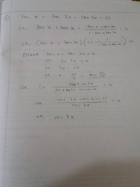

Find the general solution of the equation: $$\tan {x}+\tan {2x}+\tan {3x}=0$$
Answer given: ##x=## ##\frac {n\pi}{3}##, ##n\pi \pm \alpha## where ##\tan {\alpha} = \frac {1}{\sqrt {2}}##.

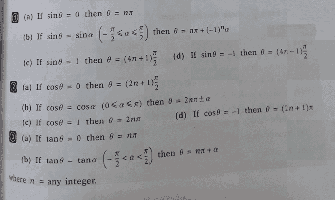

These equations may be used:
Reference table of general solutions for trigonometric equations: sin θ = 0, sin θ = sin α, sin θ = 1, sin θ = -1, cos θ = 0, cos θ = cos α, cos θ = 1, cos θ = -1, tan θ = 0, tan θ = tan α, where n is any integer.

Please see the pic below:
Handwritten derivation solving tan x + tan 2x + tan 3x = 0, factoring into (tan x + tan 2x)(1 + 1/(1 - tan x tan 2x)) = 0, with the EITHER branch giving sin 3x = 0 and x = nπ/3, and the OR branch rewritten with cos and sin.
The answer from the "EITHER" is correct, but how do I simplify the second part?
I find it hard to read and it is badly focused, so I am reluctant to type it out (after all you are too lazy to do so too ...), but I can distinguish you go from $$\left [ 1\ + \ {1\over 1-\tan\alpha\tan 2\alpha} \right ] = 0 $$ to something I don't understand and -- If I read it right -- don't believe...
Could you post the steps (typed) ?

I've posted a better picture. Please see. And the ##\alpha## in your post will be ##x##.
Better focused, yes. Understand or believe ?
Looks good as far as you went, but why did you stop?
You can throw away the denominator, and convert the cos 3x back to trig terms in x and 2x again.

Ah, the last ##\cos 3x## is more like ##\cos 3x## plus ...
I could, but I would've also got a sin term, which I can take to other side, and then cross multiply to get tan terms in x and 2x. Then?
You should get an equation involving tan x, tan 2x and a constant.
Yes, ##2\tan {x}\tan {2x}=0##.
Then...I understood. Thanks a lot.
did you mean, ##2-\tan {x}\tan {2x}=0##?
I second haru: ##2-\tan {x}\tan {2x}=0## to be solved . Repeat: see post #2.
Wrichik Basu said:
No, I did a wrong calculation. Then how will I proceed after that?
If you now have that equation, expand the tan 2x. If not, please post your working.
