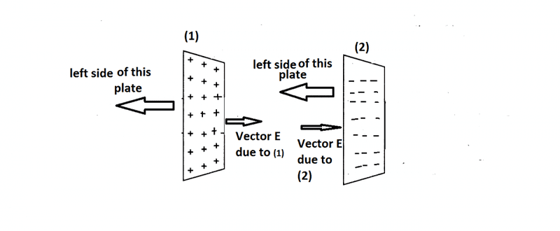

1.Homework Statement
Two large thin metal plates are parallel and close to each other. on their inner faces ,the plates have surface charge densities of opposites signs and magnitude 1.77 multiplied by 10^-11 coulomb per square meter.What is electric field
a)to the left of the plates
b)to the right of the plates
c)in between the plates
[/B]E=σ/2ε0
What is the proper orientation when the question says Two large thin metal plates are parallel and close to each other
I thought the following is correct
Diagram of two parallel plates: plate 1 on the left with plus signs, plate 2 on the right with minus signs, showing arrows for the field from each plate and labels for the left side of each plate.
But this is not correct.
The answer is Fields due to both the plates will be equal and opposite so net field will be zero.I can not differentiate between the cases that are
to the left of the plate (2) and between the plates
In part (a), "to the left of the plates" refers to the far left region; that is, the region to the left of the left plate.
Likewise in part (b), "to the right of the plates" refers to the far right region; that is, the region to the right of the right plate.

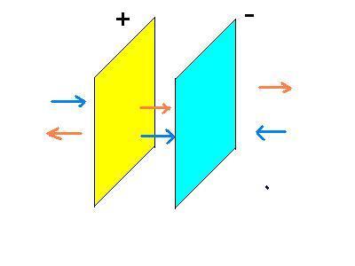

Imagine one plate: When it is positively charged, the field lines emerge from it, and point away from the plate at both sides.
If the charge is negative, the field lines enter into the plate at both sides.
You can substitute the plates by planar distributions of charges. Both planes have their field everywhere, as shown in the picture. The orange lines are due to the positive charges, the blue lines belong to the negative ones. Apply he Superposition Principle: the resultant field is the sum of the fields of the individual planes.

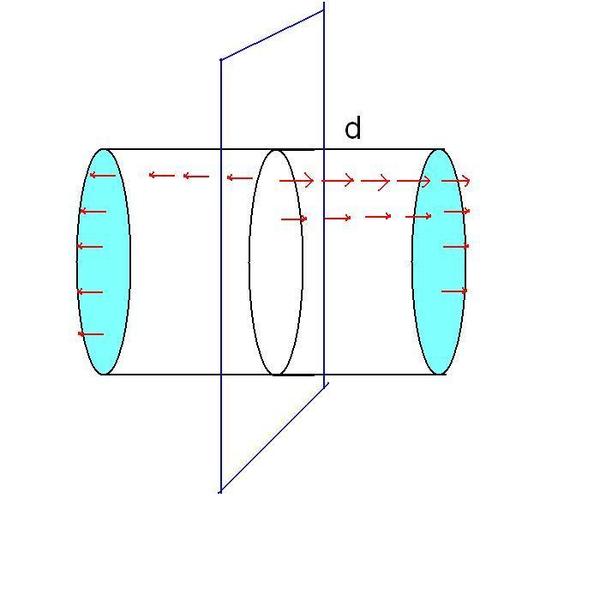

Now only one thing is remaining
Why doesn't the electric field of an infinitely large plane depend on the distance from the plane?Please can you somehow make me understand.I will give my best.
The electric field lines are perpendicular to the infinite plane if the surface charge density is the same everywhere. That comes from symmetry. The plane is the same in every direction, so the field lines can not bend in any direction.
Assume a Gaussian surface as a cylinder, with axis perpendicular to the plane and enclosing an area A of the plane. The flux of field lines is due to the bases only, and it is Φ = 2EA = Aσ/ε0, that is, E=σ/(ε0) regardless of the distance from the plane.

As far as derivation of this formula is concerned I understand .But I want to understand the concept,I want to understand how the effect of distance is nullified?I find this helpful.But still have something to ask.

No field line crosses the side of the cylinder. It can be of any length, the flux across it is zero.
