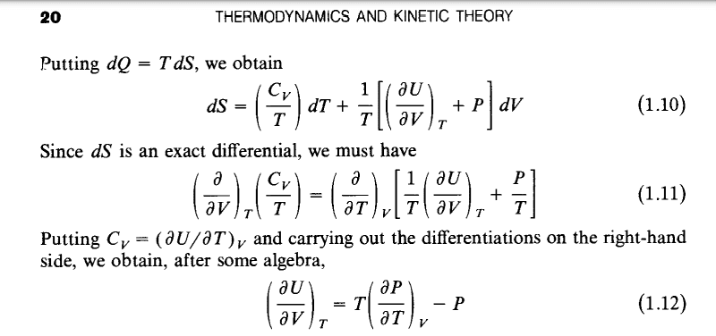

Typeset page of equations from a thermodynamics text: dS = (Cv/T) dT + (1/T)[(dU/dV)_T + P] dV (1.10), an exactness condition (1.11), and the result (dU/dV)_T = T(dP/dT)_V - P (1.12).
in this textbook : http://www.fulviofrisone.com/attach...tatistical Mechanics 2Ed (Wiley)(T)(506S).pdf ;page 20
I don't understand about Eq 1.11 come to 1.12 ? I know
dU = U_V dT + U_T dV
dQ = dU + p dV
put dU into dQ. So dQ = U_V dT + (U_T +p) dV
and i know that c_v = U_V = dU/dT when volume constant. So
dQ = c_v dT + (U_T +p) dV
and dS = dQ/T .
dS = c_v/T dT + 1/T (U_T +p) dV and ds is exact differential
d/dV ( c_v / T) = d/dT ((1/T)(U_T +p)))
i think derivative of c_v/ T by dV when T (Temperature constant) Equal to 0 . but I not sure
I need someone to explain to me. why Eq 1.11 come to Eq 1.12
Here ##U = U(T,V)## and ##P = P(T,V)##. Write:$$\begin{align*}\left( \frac{\partial }{\partial V} \right)_{T} \frac{C_v}{T} &= \left( \frac{\partial }{\partial T} \right)_{V} \left[ \frac{1}{T} \left( \frac{\partial U}{\partial V} \right)_{T} + \frac{P}{T} \right] \\ \\
\left( \frac{\partial }{\partial V} \right)_{T} \left[ \frac{1}{T} \left( \frac{\partial U}{\partial T} \right)_{V} \right]&=
-\frac{1}{T^2} \left( \frac{\partial U}{\partial V} \right)_{T} + \frac{1}{T} \left( \frac{\partial }{\partial T} \right)_{V} \left( \frac{\partial U}{\partial V} \right)_{T} + \left( \frac{\partial }{\partial T} \right)_{V} \frac{P}{T}\end{align*}$$where we used the commutativity of mixed partial derivatives. Rearrange:$$\frac{1}{T^2} \left( \frac{\partial U}{\partial V} \right)_{T}= \left( \frac{\partial }{\partial T} \right)_{V} \frac{P}{T} = - \frac{P}{T^2} + \frac{1}{T} \left( \frac{\partial P}{\partial T} \right)_{V}$$Simplify:$$\left( \frac{\partial U}{\partial V} \right)_{T} = -P + T \left( \frac{\partial P}{\partial T} \right)_{V}$$
