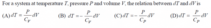

Four multiple-choice options (A) to (D) giving dT in terms of dV, each of the form dT = ±(P/C_V) dV or dT = ±(P/C_P) dV.
If I consider a specific case of adiabatic process , then ##dQ = 0 ## and ##dU = -PdV ##
If we differentiate with respect to T on both sides , ##\frac{dU}{dT} = -P\frac{dV}{dT}## . Now , the closest I see is option B) , but ##C_V = \left ( \frac{dU}{dT} \right )_V## not simply ##\frac{dU}{dT}## .
I do not have much idea . Please help me with the problem .

Try using your understanding instead ... for the question to make sense, which of the variables are changing?
Which answer(s) are consistent with those variables changing?

The specific error is in the approach to the problem. The problem is testing your understanding of the physics and not your ability to choose the correct equation.
Since the problem does not refer to the adiabatic process, or any specific process, it would be a mistake to assume adiabatic or any specific process.
But you can attempt to use the clues in the problem statement and the possible answers along with your understanding of the physics involved to work out the best answer out of the four.
But you can try guessing what equations apply if you like.

The way I look at the problem, you are given three variables, T, P and V. At least two of them are allowed to vary (there are two differentials given). More-so, since only two differentials are given [in the list of choices], I'd say that only two of those variables are allowed to vary. So which one is not varying? Which of the variables is held constant? What is the process called with that particular variable held constant? [Edit: And which particular heat capacity (Cv or Cp) applies when that particular variable is held constant?]
In an ideal gas, in such a process, are T and V directly proportional to each other or inversely proportional? (That might help determine if the slope of the line is positive or negative.)

Nice to see your reply . If I am understanding you properly , you are hinting that process is isobaric and option D) is correct .
Right ?

That was what I was hinting at, yes. :smile:

But in this case, the problem statement specified T, V, and P. Obviously, T and V are allowed to change, even if by a small, infinitesimal amount. (Edit: this is obvious since we're finding the relationship between dV and dT.)
The problem statement never mentioned enthaply or entropy at all, so I suspect that they are not relevant. Since it mentioned P, but no mention of dP, I assume that dP is 0, and thus P is what is held constant.

Putting it another way, here is how I interpret the problem:
Suppose you have a system with a roughly constant temperature T, volume V, and pressure P. If you ever so slightly "wiggle" the system's volume, how does that affect the system's temperature, all else being the same (i.e., the pressure is kept the same)? (You may ignore the system's enthalpy and entropy; they may change as they will in response to your "wiggle" in the volume under constant pressure.)
