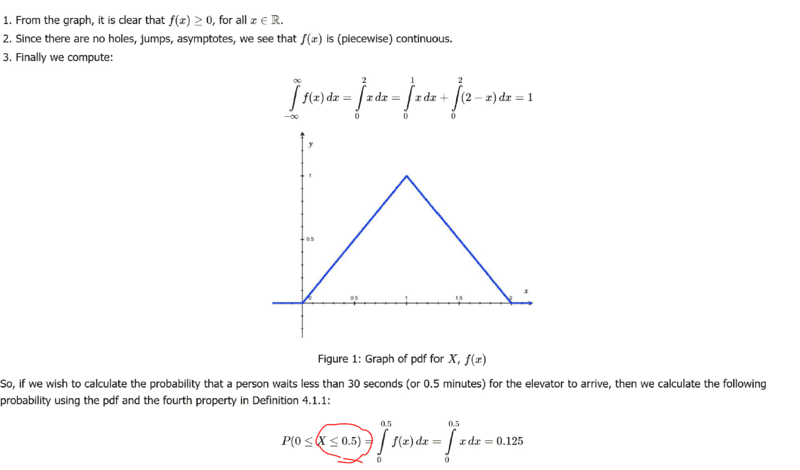

Screenshot of a textbook page with numbered steps, a triangular pdf graph of f(x) on axes with peak at x = 1, and the integral from 0 to 0.5 of x dx equal to 0.125, with the inequality X ≤ 0.5 circled in red.
I just want to be certain, i think the inequality indicated is not correct...ought to be less than. Kindly confirm...This is a textbook literature.
In terms of continuous probability distributions ##< 0.5## and ##\le 0.5## are equivalent, because the point ##0.5## itself has zero width (or zero measure if you prefer).
Thanks Perok, so the pdf indicated above is just the same as finding the cdf at ##x=0.5## right? giving us ##F(0.5)=0.125##.
I think so. I haven't looked very carefully at the material you posted.

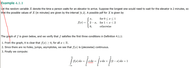

Textbook example 4.1.1 with a piecewise pdf f(x): x for 0 ≤ x ≤ 1, 2 − x for 1 < x ≤ 2, and 0 otherwise, followed by the integral computation of the total probability equal to 1.
ought to be integral of ##f(x)## and not ##x##... or is it fine the way it is?
