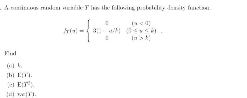

see attached
understanding of continous and discrete distribution
I am refreshing on this; ..after a long time...
Note that i do not have the solution to this problem.
I will start with part (a).
##f(u)= 3u-\dfrac{3u^2}{2k}## with limits ##0≤u≤k##
it follows that,
##3k - \dfrac{3k}{2}=1##
##\dfrac{3k}{2}=1##
##k=\dfrac {2}{3}##
For part (b),
##E(T)=\int_0^{\frac{2}{3}} u⋅(3-\dfrac{9}{2}u )du=\left[\dfrac{3}{2}×\dfrac{4}{9}-\dfrac{3}{2}×\dfrac{8}{27}\right]=\dfrac{6-4}{9}= \dfrac{2}{9}##Ok let me know if that's correct...
Those both look OK to me. Do you know how to do the last two parts?

##E(T^2)=\int_0^{\frac{2}{3}} u^2⋅(3-\dfrac{9}{2}u )du##
##=\int_0^{\frac{2}{3}} (3u^2-\dfrac{9u^3}{2} )du=\left[u^3-\dfrac{9u^4}{8} \right]##
##=\left[\dfrac{8}{27}-\dfrac{9}{8}×\dfrac{16}{81}\right]=\dfrac{8-6}{27}= \dfrac{2}{27}##
##⇒Var (T) = \dfrac{24-4}{81}=\dfrac{20}{81}##
...this part is easy and straightforward. Bingo!
Where does the 24 in the variance come from? Shouldn't it be a 6?
True...let me amend that.
##⇒Var (T) = \dfrac{6-4}{81}=\dfrac{2}{81}##
