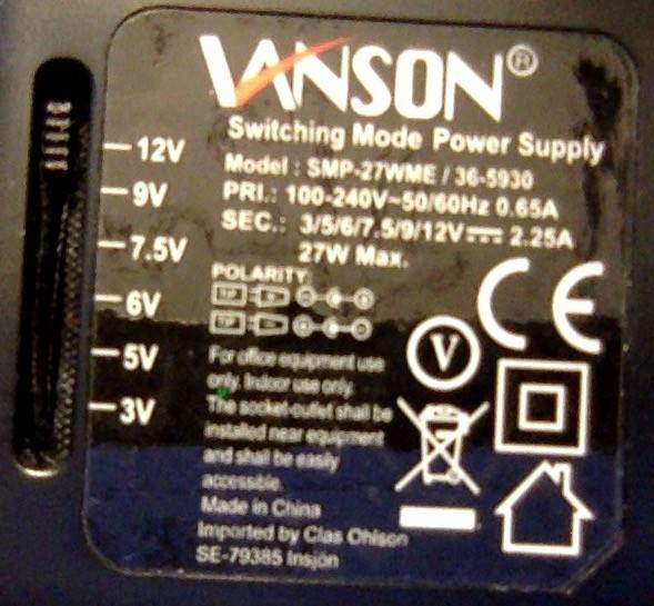

I have a very nice Christmas electric candlestick that is I can no longer get to work properly. Originally, it came with incandescent light bulbs running in 6 V DC. Some of the lights have burned out, so I looked for replacements and can now only find LED lights. The ones I got are labelled as AC/DC 10-55 V, so I bought a new transformer capable of 12 V DC, but I can't get the bulbs to light. I have even tried with a single bulb (out of 7 total), and it lights for a fraction of a second when I flip the switch, but that's it.
Any advice on what is going wrong? Do I need to find another transformer? By the way, I have tired both polarities, but that's not the problem.

The only thought coming to mind for why an 10-55 VDC/AC LED replacement won't work when fed from a 12 VDC, 27W supply is load current is below the minimum for this particular switching supply. Do you have a junk box of resistors at hand, or another way to put more load on the supply?
I've never been much of an electronics enthusiast :sorry: I'll try an see if I can find a resistor somewhere. What resistance do you suggest?

Supply has 27 watt output rating so if we suppose 10% loading is required to keep the switcher running that's about 3 watts. Voltage is set to 12 volts. P=E2/R, so R=E2/P, or about 48 ohms, so a 47 ohm resistor rated 5W ought to do for the test.

Supply is 27 watts max., switchable from 3V to 12V at 2.25 amps. It isn't clear to me how Vinson is specifying this. They have a website, but it appears to be down right now. Found a "manual" at clas ohlson, but it doesn't add to what we know from the sticker. 27 watt/12V = 2.25 amp. Current would be 9 amps at 3 volts (27W/3V), so does the 2.25A current rating mean it can deliver only 6.75 watts when set to 3 volt?
Bulb rating is 0.3W at 10-55 volts AC/DC.
At 12 volts, 0.3W is 25 milliamps.
Seven lamps in parallel is still only 175 milliamps, or 7.8% (0.175A/2.25A) of rated power supply current so we're far from overloading it.

Was the 7.5V supply a switch mode or linear?
LEDs that are intended to be chained in series may require constant current source vs. contant voltage source. The 10-55V range may be what the supply is expected cough up as we add LEDs while operating at its fixed current.
