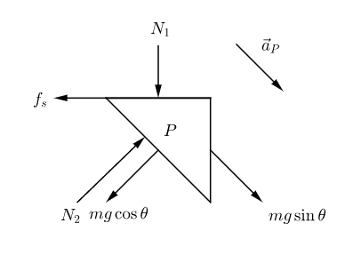

A man of mass ##80## kg, stands. on a horizontal weighing machine, of negligible mass, attached to a massless platform P that slides down a ##37^{\circ}## incline. The weighing machine reads ##72## kg. Man is always at rest w.r.t weighing machine.
Calculate:
(a) The vertical acceleration of the man.
(b) The coefficient of kinetic friction ##\mu## between the platform and man.
$$\begin{align}
&f_k\le \mu_{k}mg\qquad\qquad \text{where, $\mu_{k}\rightarrow$ coefficient of static friction} \\
&f_s\le \mu_{s}mg\qquad\qquad \text{where, $\mu_{s}\rightarrow$ coefficient of static friction} \\
&F=ma
\end{align}$$
The first part of the question was pretty easily solve but its the second part where I am having the problem.
$$m_Mg-N_1=m_Ma_P\sin{37^{\circ}}\qquad\qquad\text{where, $m_M$ is the mass of man} \\
\implies (80-72)g=80a_P\left(\dfrac{3}{5}\right)\implies a_P=\dfrac{5}{3}\text{m/s$^2$}$$
So, from the above FBD of the man standing on the platform we see that
$$f_s=m_Ma_P\cos\theta$$
From the above equation, I concluded that for the platform and the man to not move relatively to each other its not necessary that the friction acting b/w the man and the platform be the maximum static friction, so I don't think we can find the coefficient of "kinetic friction", even though if it had been possible we could have only found the coefficient of static friction. Now, if we were to find the coefficient of the static friction shouldn't the question have also mentioned that the force of friction acting b/w the surfaces to make them move together is the maximum friction.
Also, the coefficient of friction that I found is
$$(f_s)_{max}=m_Ma_P\cos\theta\implies \mu_sN_1=80\left(\dfrac{5}{3}\right)\left(\dfrac{4}{5}\right)\\
\implies \mu_s(72g)=80\left(\dfrac{5}{3}\right)\left(\dfrac{4}{5}\right)\implies \mu_s=\dfrac{4}{27}$$
So, the coefficient of friction that I got is ##\mu_s=\dfrac{4}{27}##, whereas the book got the coefficient of friction as ##\mu=\dfrac{13}{24}##. So, can you please point out where am I going wrong.

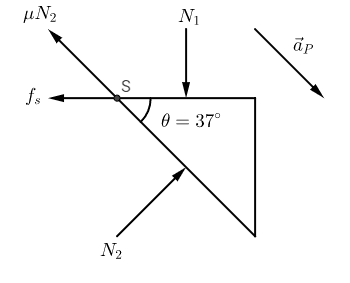

Now, as the platform P is massless so, from its FBD we get the following equations:-
$$N_2=f_s\sin\theta+N_1\cos\theta=640 N\\
\mu_k N_2+f_s\cos\theta=N_1\sin\theta\implies \mu_k=\dfrac{13}{24}$$

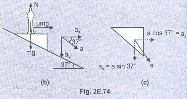

Textbook's Solution:-
$$(80-72)g=ma_y\implies a_y=1\text{m/s$^2$}\\
a_y=a\sin{37^{\circ}}=1\text{m/s$^2$}\implies a=\dfrac{5}{3}\text{m/s$^2$}$$
Now apply Newton's second law on man in direction of acceleration. Note that ##x-##component of acceleration is due to friction.
$$mg\sin{37^{\circ}}-\mu mg\sin{37^{\circ}}=m\times(5/3)\\
\implies 6-8\mu=5/3\implies 6-(5/3)=8\mu\implies \mu=\dfrac{13}{24}$$
According to the FBD that the book has drawn is it not that that the book is finding the coefficient of friction b/w man and the platform not b/w platform and incline.
You are right, so it turns out that the error in the book is that it should have asked for the minimum static friction, not the kinetic friction, and by coincidence both "error corrected" versions of the question have the same answer.
By the way, there is an error in one line of the textbook solution as you have posted it. It should read ##mg\sin(37)-\mu mg\cos(37)##.
