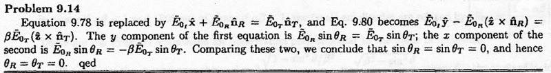

This is the original question word by word:
In writing Eq.9.76 and 9.77, I tacitly assumed that the reflected and transmitted waves have the same polarization as the incident wave...along the x direction. Prove that this must be so.
Hint: Let the polarization vectors of the transmitted and reflected waves be:
##\hat n_T=\hat x\cos\theta_T+\hat y \sin\theta_T\;\hbox { and } \;\hat n_R=\hat x\cos\theta_R+\hat y \sin\theta_R##
and prove from the boundary conditions that ##\theta_T=\theta_R##.
##\hbox{(9.76)}\;\Rightarrow\;\tilde E_R(z)=\hat x E_{0R}e^{-jk_1z}\;\hbox { and }\;\tilde B_R(z)=-\hat y \frac 1 {v_1}E_{0R}e^{-jk_1z}##
##\hbox{(9.77)}\;\Rightarrow\;\tilde E_T(z)=\hat x E_{0T}e^{-jk_2z}\;\hbox { and }\;\tilde B_T(z)=\hat y \frac 1 {v_2}E_{0T}e^{-jk_2z}##This is from "Introduction to Electrodynamics" 3rd edition by Dave Griffiths, the gold book for undergrad physics. The pages of relevant are page 384 to 386.

This is a scanned copy of the solution manual, I don't even know why the author went through the trouble to proof ##\theta_T##=0! So if it is zero, what does that prove the polarity of ##\tilde E_R## and ## \tilde E_T## is same polarity as ##\tilde E_I##?
