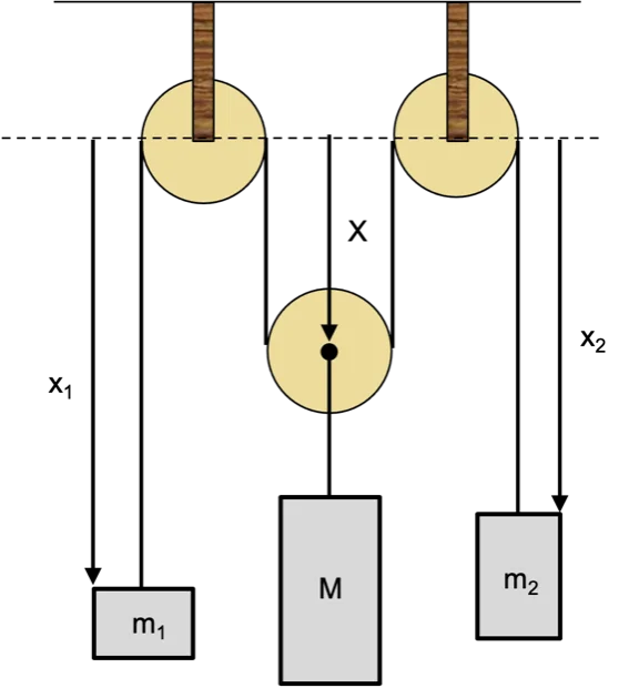

Consider the setup shown in the figure below. Two weights, with masses ##m_1## and ##m_2##, hang on the outside of a three-pulley system, while a weight of mass M hangs on the middle pulley. We assume the pulleys and the connecting rope have negligible mass, so their kinetic and potential energies are also negligible. We will suppose for now that all three pulleys have the same radius R, but this will turn out to be of no importance. Calculate the accelerations of ##m_1,m_2## and ##M##.
Newton's law : Net force ##\displaystyle{\Sigma F = ma}##
[The problem involves the use of Lagrange's equations for conservative systems. I am first trying to solve it using Newton's mechanics, similar to that of a school student]
Diagram : The diagram of the problem is shown to the right.
Solution : The tension is the same all over the (same) rope - let's assume it to be some value ##T##.
The masses ##m_1## and ##m_2## accelerate up with an acceleration of ##2a## if we assume that the mass ##M## moves down with an acceleration of ##a##. This is because the movable pulley has two sides that move down with ##a##. This has to be "accounted for" by just one rope connected to masses ##m_1## and ##m_2##, which have to move up with ##2a##.
Writing the equations of motion for each mass :
(1) ##\underline{m_1}## : ##T - m_1g = 2m_1 a\qquad (1)##
(2) ##\underline{m_2}## : ##T - m_2 g = 2m_2 a \qquad (2)##
(3) ##\underline{M}## : ##Mg-2T = Ma\qquad (3)##
Immediately I notice something's wrong. I have two unknowns, viz. ##T,a## but three equations where the masses are independent of each other.
Request : Where am I going wrong? A hint would be very appreciated.

You have assumed that the left hand mass ##m_1## and the right hand mass ##m_2## accelerate downward at the same rate, ##a##.
What if they accelerate at two different rates, ##a_1## and ##a_2##?
brotherbobby said:
The masses m1 and m2 accelerate up with an acceleration of 2a if we assume that the mass M moves down with an acceleration of a.
This makes no sense. If m1 and m2 are different masses but rope force on them is the same, how can they have the same acceleration?
brotherbobby said:
This is because the movable pulley has two sides that move down with a. This has to be "accounted for" by just one rope connected to masses m1 and m2, which have to move up with 2a.
Think again. Even if m1 = m2, so a1 = a2, then a1 = a2 = a, not = 2*a. The center pulley doesn't even rotate in that case.

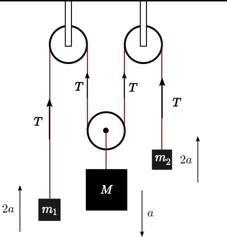

@brotherbobby, if you haven’t yet cracked it, here’s a short exercise which might help you see what's going on.
Let ##L## be the total length of the 2 internal string-sections – shown in red in the diagram.
In each of the following cases, what is:
i) the change in the total length of the 2 internal string-sections, ##\Delta L##;
ii) the height-change of the centre mass, ##\Delta Y##.
I’ve even done the first one for you!
a) ##\Delta y_1 = +3## cm and ##\Delta y_2 = +3## cm (i.e. both ##m_1## and ##m_2## risea a distance of 3 cm).
Answer:
i) ##\Delta L = 6## cm.
ii) ##\Delta Y = -3## cm.
Make sure you understand why!
b) ##\Delta y_1 = +3## cm and ##\Delta y_2 = -3## cm.
c) ##\Delta y_1 = +3## cm and ##\Delta y_2 = 0##.
d) ##\Delta y_1 = +3## cm and ##\Delta y_2 = 1## cm.
e) ##\Delta y_1 = +3## cm and ##\Delta y_2 = -1## cm.
Can you see the pattern? Can you express ##\Delta Y## as a simple function of ##\Delta y_1## and ##\Delta y_2##? ?
M’s acceleration in terms of the accelerations of ##m_1## and ## m_2## then immediately follows.

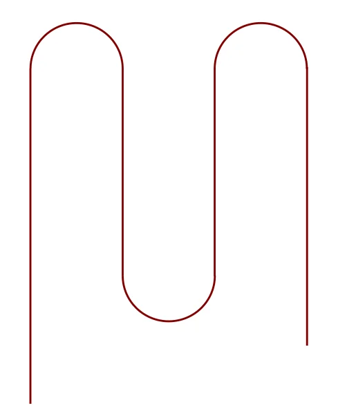

Another approach is shown on the right. Consider the invariant length of the string, ##L##. You can write is as $$L=x_1+2X+x_2+C$$ where ##C## is the (constant) total length of string in contact with the pulleys. When you take the second derivative of this, you have a fourth equation. Add it to your collection and you will have four equations and four unknowns, ##T##, ##\ddot x_1##, ##\ddot X## and ##\ddot x_2.##
You could use ##x_1##, ##X## and ##x_2## as your generalized coordinates when you work out the Lagrangian.

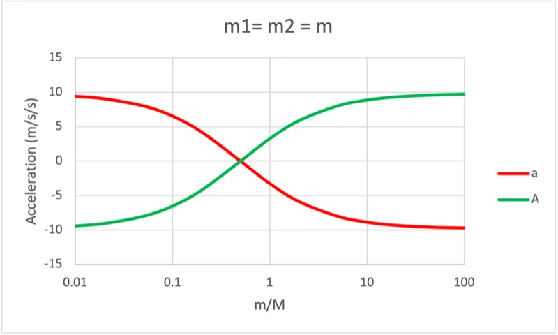

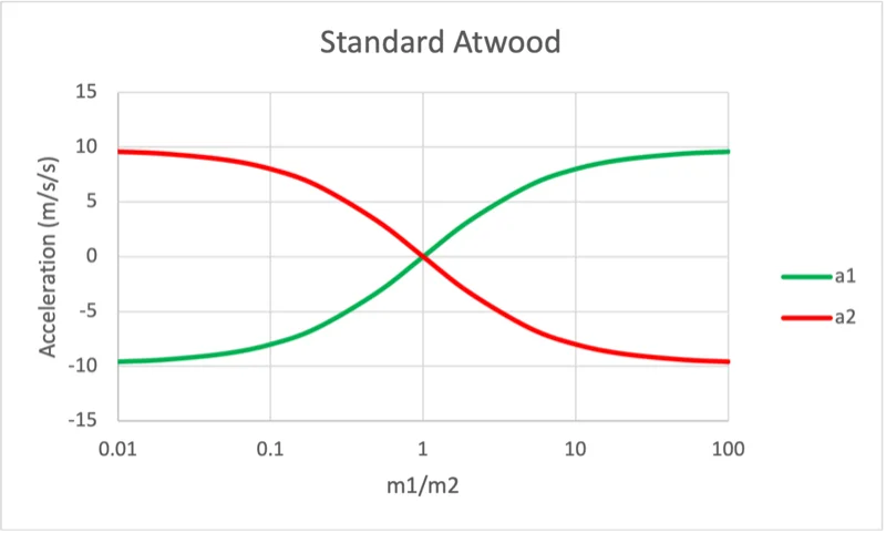

This problem can be solved quite easily (and more quickly) without Lagrangians. It helps to write the masses in terms of the middle mass, i.e. ##m_1=\alpha M~;~~m_2=\beta M##. I have the solution ready to post when it would be permissible to "spill the beans." Until then, I post a figure that shows the three accelerations for ##~0.01 <m_1/M < 100~## and ##m_2=M## and ##g=9.81~\text{m/s}^2.##
Note that the abscissa is logarithmic. The graph shows what everybody has been saying, "The three accelerations depend on the choice of masses."

In the special case ##m_1=m_2## it follows by symmetry that ##\ddot x_1=\ddot x_2## in which case ##\ddot X = -\ddot x_1=-\ddot x_2.##
The accelerations for ##m_1=m_2=m## are shown in the graph below left. The acceleration of the inner strings (green line) has equal magnitude and opposite direction to the acceleration of the outer strings (red line) for all mass ratios ##m/M##. There is an equilibrium point where all accelerations are zero at ##(m/M)=\frac{1}{2}.## This picture is analogous to the standard two-mass Atwood machine (below right) with the exception that the equilibrium point is shifted to a mass ratio of 1.

I think I misunderstood this part. You simply say that in the rest frame of the axis of a pulley, both rope segments at that pulley have the same acceleration magnitude. That is of course true for all pulleys.
But since here there is no common rest frame for all the pulley axes, one cannot assume that all rope segments have the same acceleration magnitude.
I think the OPs misconception here comes from starring at a static diagram of the rope, and imaging the rope flowing along that fixed shape. But with relative motion between pulley axes, that shape continously changes.
