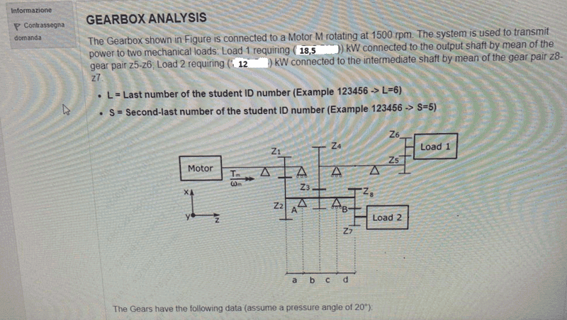

Greetings, I have tried to find the reactions of the bearings on the Y direction in the intermediate shaft. but I couldn´t find the numerical results of the solutions
here is my attempt:
in order to find the forces I did the moment equilibruim around the point A and B
With FT1 FT2 and FT3 the tangential forces applied by the gears on the intermediate shaft and RyA and RyB are the reaction forces I´m trying to find.

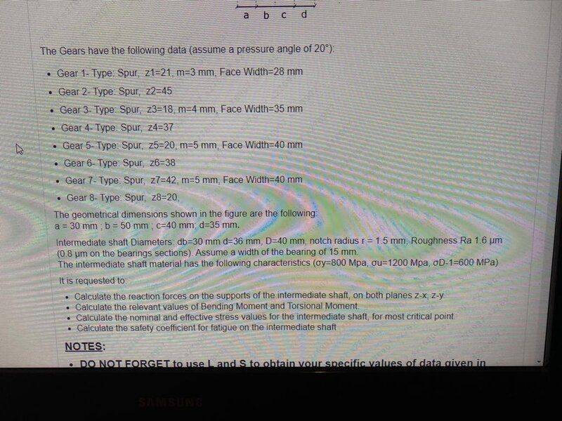

Also, are you supposed to calculate the reaction forces on both planes?
I ask because the solution values that you show seem to be accounting for the contact pressure angle (thrust force on plane z-x), rather than being reasonable for the power force on plane z-y.

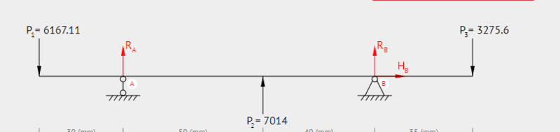

thanks a million! you mean that my feeybody diagram is wrong? if so this might explain why my results are wrong?
Could you tell what are the wrong directions?
yes the exercice ask about the the reactions on the the other plane by I can solve them once i fix this first!
thanks a million!
I used an online software to calculate the reactions and I got the same results if my initially supposed directions are correct.
(ignore the fact that I inverted the bearings here as I´m not calculating forces in the x directions right now)
