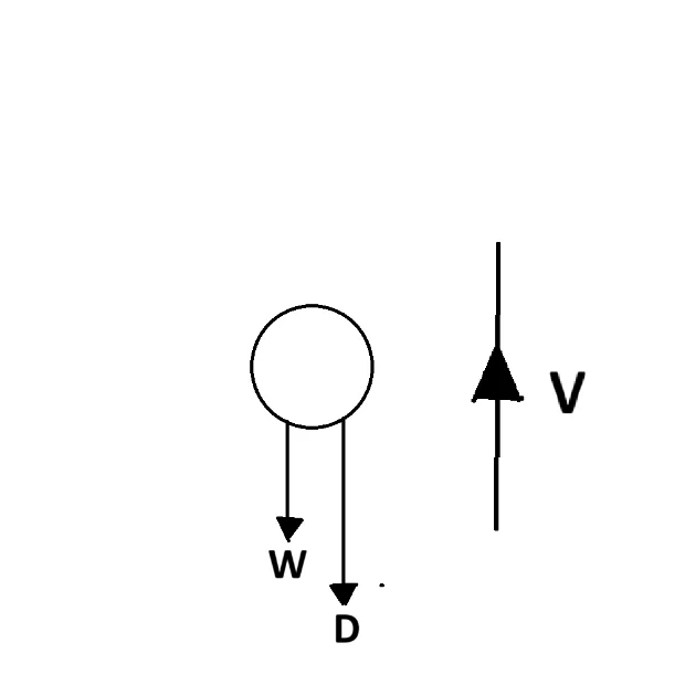

So the particle is moving upwards with a velocity V and forces W (weight) and D (drag) acting against it. $$
F = -WD $$
$$W = mg $$
$$D = \frac {C_d \rho A V^2}{2} $$
$$F = -mg-\frac {C_d \rho A V^2}{2} $$
$$\frac {F}{m} = a $$
$$a = -g -\frac {C_d \rho A V^2}{2m} $$
$$c = \frac {C_d \rho A}{2m} $$
$$a = -g - cV^2 $$
$$a = \frac {dV}{dt} $$
$$\frac {dV}{dt} = -g -cV^2 \\$$
erobz said:
What do you find for max height after you change the independent variable to height via dvdt=dvdhv and solve for it directly?
