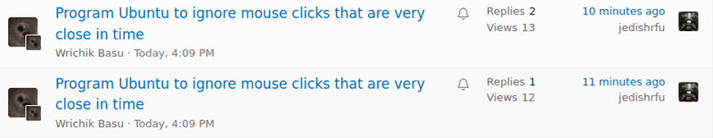

Things just went to the next level: the double click problem created two threads, one after the other:
I got two notifications with the same thread name, one with @pbuk's reply, and one without it. Then saw the two threads had different ID: 1011641 and 1011642. :H

I removed the other thread.
