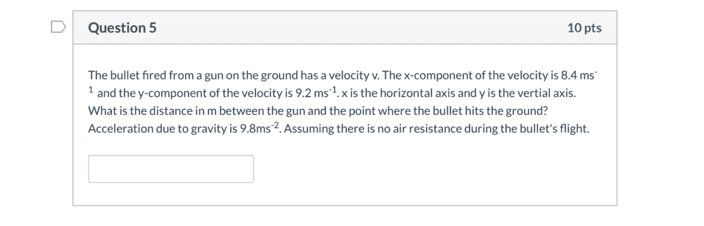

The bullet fired from a gun on the ground has a velocity v. The x-component of the velocity is 8.4 ms-1 and the y-component of the velocity is 9.2 ms-1. x is the horizontal axis and y is the vertical axis. What is the distance in m between the gun and the point where the bullet hits the ground? Acceleration due to gravity is 9.8ms-2. Assuming there is no air resistance during the bullet's flight.
Not sure
I don't know how to link the x-component and y-component together.

Distance, start velocity, final velocity, time, acceleration. For which does the same value apply to both coordinates?

As there is no air resistance, the vertical and horizontal components of velocity are not linked in the problem.Consider the problem as independent horizontal and vertical motions.

Don't link those, they are giving you the vertical and horizontal components of the initial velocity in order to facilitate the problem.
Hits:
Purely vertical movement: decelerated while moving up / stop / accelerated while falling down.
Purely horizontal movement: non-accelerated and lasting as much as the up-down vertical movement.

It's not clear what @Tinkylo means by linking them. My interpretation is finding something that links the horizontal and vertical equations. See my hint in post #2.

You can work it out from first principles from the equations for x and y as a function of t (time). This involves finding the value of t when y = 0 and then using that value of t in the equation for x. Or you can use the relationship between range, velocity and launch angle that you may have been given: ##R = \frac{v_0^2 \sin{2\theta}}{g}##. If you use this relationship, you will have to find ##v_0## and the launch angle. Which method do you wish to use?
