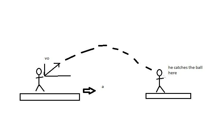

A person is traveling in an accelerating car. He throws a ball in the direction the car is acceleration with a velocity of vo. In the final condition, he catches the ball. Note the car begins accelerating after the ball is thrown.
What is the time the ball is in the air in terms of vox and a?
2. Equations
Projectile motion ones?
Well, the ball and the person have the same a. Also, x (the distance traveled) and t (time) are the same.
I have no idea how to setup this up or what approach to use.
F=ma doesn't really help, it just comes down to a=-g.
TIA
I attached a pic. in case my description doesn't help

x and t are, indeed the same. However, the ball and the person do not have the same acceleration. What happens to the ball's acceleration as soon as the ball leaves the person's hand?

Ignore the y-component. And we don't need the angle. They are both completely unnecessary for this problem. What is the x-component of acceleration of the ball, after it leaves the person's hand? Once you realize what it is, what equations can you use?EDIT: It's also important to know if the car/person is accelerating at a constant acceleration.

The ball you throw will not have an acceleration in the x direction since the only force acting on it is gravity, which affects it only on the y axis, so the formula for the displacement of x is Δx = (Vox)(Δt)
The car starts accelerating but at the beginning it is at rest, so its formula for x displacement is Δx = 0 + (1/2)(ax)(Δt)
For him to be able to catch the ball from his car, their Δxs need to be equal so his hand and the ball are at the same place, so make both equations equal each other:
(Vox)(Δt) = (1/2)(ax)(Δt^2)
That's it.

Again - we don't care about the angle, or the y-component or gravity. We are only concerned with what's going on in the x direction. Since you know that the distance traveled is the same for both the ball and person, you can set two equations (one each for distance traveled) equal and solve for t that way. Also, since you know that the person doesn't start accelerating until he's thrown the ball, you know what v_0 is. And think about what the acceleration is in the x-direction for the ball. You'll see that a couple of terms simply drop out, and you're left with two equivalent equations for distance - one of the ball, and one of the person.

well i think it is this
for ball
x=Vox*T
for person
x= 0.5*A*T^2.
is that correct?
so
Vox*T=0.5*A*T^2
2*Vox=A*T
and thus
T= 2*Vox/A
is that right?
YES! Now, since x is the same for both, just set the two equations equal to each other and solve for t.
Yeah, that's it. It's one of those problems that seems tougher than it really is.
