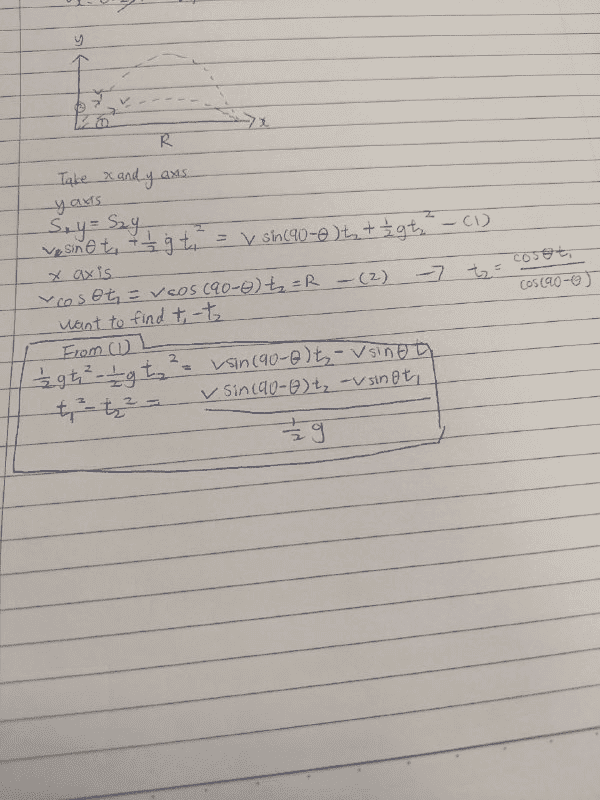

When 2 projectile motions are launched with velocity v, one at angle x and the other one at angle 90-x Derive an expression for the time difference in terms of range, x and g
R = v^2 sin2x / g
The below attempt will look messy, but I'm really kind of stuck as how to proceed on here. Thanks for any advice.
You are making things difficult for yourself. ##S_{1,y} = S_{2, y}## is correct, but since they are both equal to zero, one factor of ##t_i## drops out...
Do I drop out t1 from the beginning where s1y=s2y, or do I drop it out at my last step?
You have $$S_{1,y} = 0 \quad \Rightarrow v \sin\theta_1\; t_1 + {\scriptstyle {1\over 2}}\,g\,t_1^2 = 0 \Rightarrow t_1 = ... $$I would drop the factor ##t_1## straightaway (it is the trivial one of two solutions for S=0).

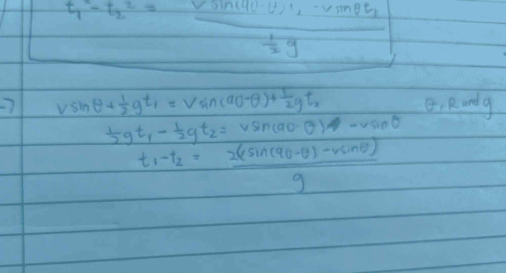

Alright it looks cleaner now, but now I have to get rid of v. If I used vcos theta t1 = R , this means v = R/cos theta t1, which I suspect it will be problematic. Any ideas on proceeding on from here?
You have your relevant equation for R
And ##\sin(90^\circ-\theta)## looks really ugly to me :rolleyes: . Alternative ?
So does ##\sin (2\theta) ## :wink:

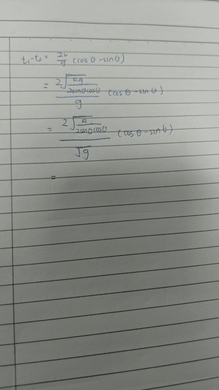

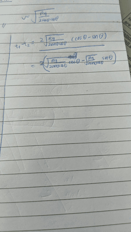

Hi, as per your hints:
I think I might have messed up as the final answer provided is drastically different from this. Any ideas on where I might have messed something up?
My route was to write v as a square root in the expression for ##t_1-t_2##

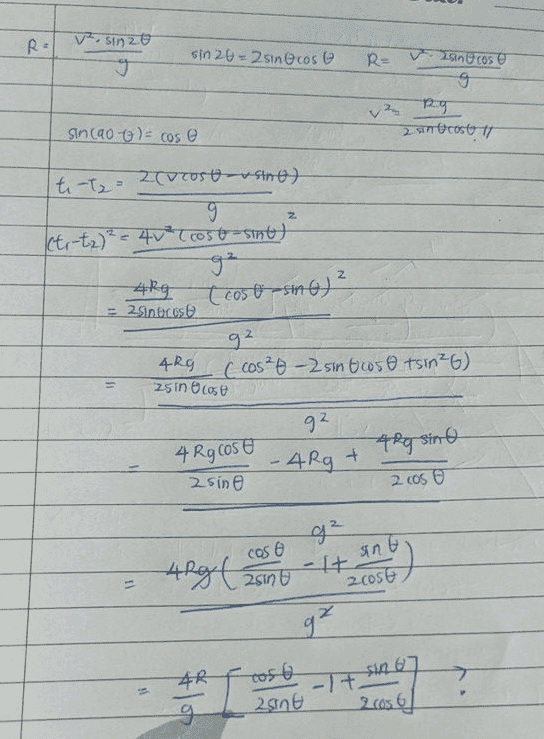

OK will do that and get back to you

jisbon said:
Did you mean something like this?
You seem to have gone wrong in the second line, using something like t=2vx (?)
I preferred the top half of your post #7, down to where you had cos2+...+sin2. With that hint, try to simplify differently.
In the cos^2 theta + sin^2 theta equation though, I have already subbed v in as the square root of... already though. The only thing I can proceed on seems to be only simplifying it which I have done

As per both of your instructions, I have done this:
Now I know this is more of a Maths question now rather than a physics question, but how do I get rid of the 2sin theta cos theta in this case? Thanks
