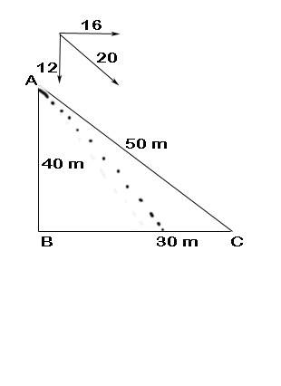

A boy standing on the top of a building 40m high throws a ball directly aiming to his friend standing on the ground 30m away from the base of the building. If the projection velocity is 20m/s. Find how short will the ball fall from his friend.
From the picture I have attached, AB = 40 m
BC = 30 m
Using pythagoras theorem, we have AC = 50 m
Using tan θ = p/b we have tan θ = 40/30 so, θ = tan-1(4/3) = 53°
Now, breaking the components,
Horizontally:
20 * cos53° = 16 m/s
Vertically,
20 * sin 53° = 12m/s
My problem begins here :
1) Which formula do I use, s = ut + 1/2 at2 or v = u + at to find the time it takes to reach ground vertically.
2) What's the sign of u and g here.
  • Diagram of a right triangle ABC with B at the bottom left, A at the top left and C at the bottom right. AB is labelled 40 m, BC is labelled 30 m and hypotenuse AC is labelled 50 m. At the top, a 20 vector points down-right at an angle, with components labelled 16 horizontal and 12 vertical.
Use the first equation, s = ut + 1/2 at2 to find the time it takes to reach the ground, u would be 0 since there is no initial vertical velocity.

1) You have only intial velocity and you can choose which is appropriate.
2) You can take going up as positive or down as positive. Once you make a convention on the sign of direction, all vectors direction should follow this convention.
