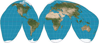

anorlunda said:
By all the criteria in your bullet list, Earth is already an ocean world. That is unless you consider a continent as different than an archipelago for map purposes.
It certainly is different.
You don't do this on a world without continents:

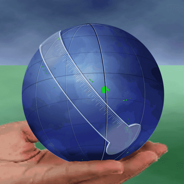

It might help if I made it clear that these are humans. They're on a colony world. So they bring their historical science and math with them.
Still, I had the same stroke of lateral thinking as you. A small globe - one that stores compactly but unfolds like the petals of an orange peel - would make an excellent map for such a world.
It's possible to make a worldline straightedge that can be rotated to any position to show as-the-crow-flies courses (and if it's constructed right, it won't fall off).
I whipped this up in 90 minutes or so. Needs a little refining but it serves for the story.

A collapsible pocket globe with a wraparound straight edge - as pictured in post 8 - looks like a good solution.
Only downside to it is the scale - which is about 1:68,000,000. Of course it can be supplemented by larger scale flat maps near locations of interest.

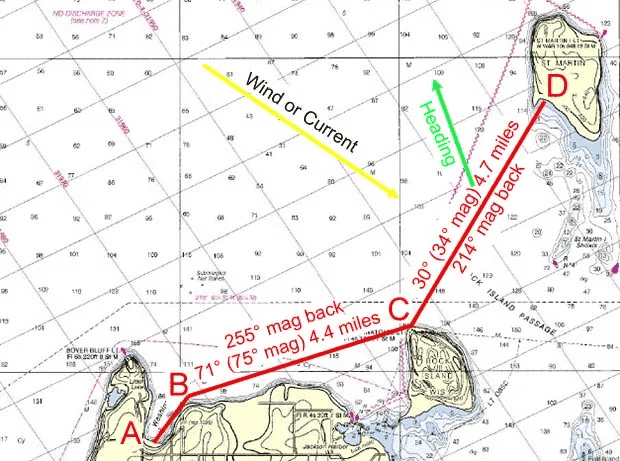

I say almost because we don't take distances and angles from a chart for long distance navigation, and neither did the ancients IMO. Short distance navigation is different. There, we print a compass rose on the chart, and you can use parallel rulers to mark headings.
What we do see on some charts are sailing routes with reciprocal magnetic headings marked. (See below.) In those cases, the useful navigational data is printed on the map as numbers, not measured as angles on the chart. Distortion doesn't matter. I'm sure that the ancients did likewise. On your SF world, it would be far superior to print the magnetic headings between every pair of neighbor islands on the chart, than to try to take distances and angles off the chart graphics.

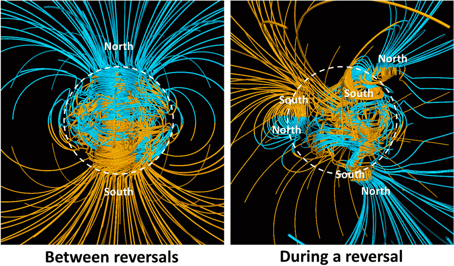

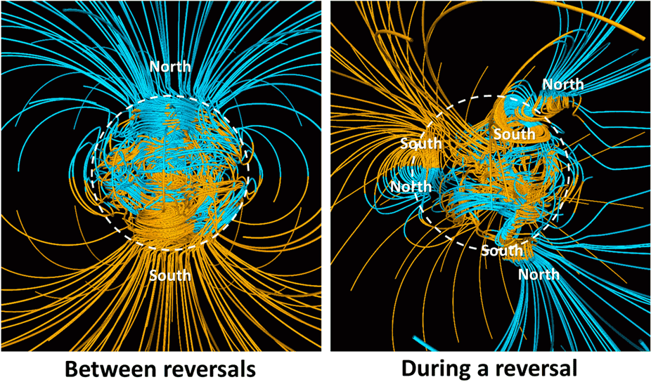

Does your SF world have magnetic poles? If not, then there's more to navigating than just charts. Note the difference between course and heading on the above picture. If they had advanced technology, then surely they would have apps that resemble GPS, instead of paper maps. Even without satellites, the apps could use inertial, celestial, radio, or other means of navigation.

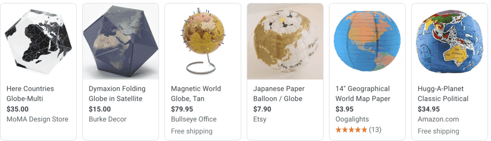

Here are some non-electronic collapsible globes I googled up.
The future might have better ones based on advanced origami techniques.

Heh.
I like the Chinese lantern one. Collapses nice and flat.
And the huggable one could - with sufficient technology - blow up to a perfect sphere. Hmm. That's even better than my grapefruit-peel segmented globe.
