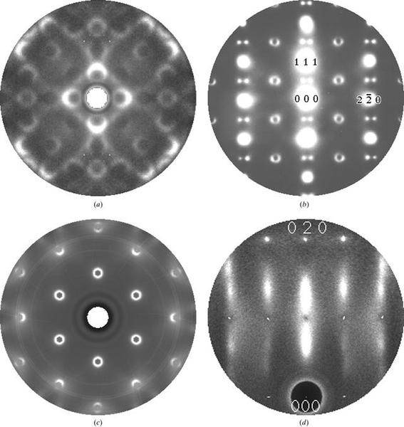

Correct. You instead get an X-ray diffraction pattern:
Because the X-ray diffraction pattern is directly created by the arrangement of the atoms, it is used as a tool to find the atomic arrangement of a material. The helical structure of DNA was discovered using X-ray diffraction.
azaharak said:
What if we sent xrays through a glass which has random orientations of molecules. How would this scatter differently from xrays through a diamond?
Diamond x-ray diffraction pattern:
For, glass, there would be rings instead of spikes.
