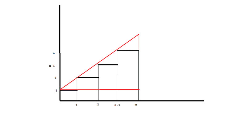

I thought of another way of proving it that seems more natural... please look at it and tell me what you think...
I created a step function then sections it off into a rectangle and a triangle...
1. area of rectangle = (b)(h) = (n)(1)
2. area of large triangle = (b)(h)/2 = (n)(n)/2
3. area of small triangle's = n/2Area of ordinate satisfying greatest integer function from [0,n] is the sum of these areas...
(n)(1) + n^2/2 - n/2 = n(n-1)/2..
Never mind I just looked at it and realized it does not equal n(n-1)/2
You did the algebra wrong. n+n^2/2-n/2=n*(n+1)/2. But yes, you work it out like that, but I think your graph is wrong. Isn't [t] the greatest integer less than or equal to t? Shouldn't [1/2] be 0? That's not what your graph shows.
your correct... I realized that it was equal to n*(n+1)/2., which I replied back to saying that... and yes my graph is wrong... thank you.
