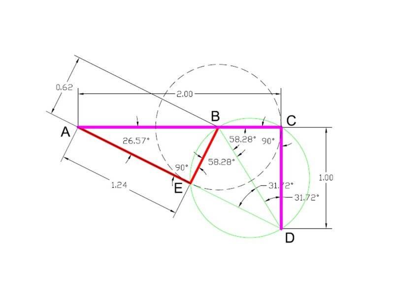

@anuttarasammyak , attached is the same drawing, with improved resolution for the angles and measurements of the sides of the triangles.
Nice ...what's your ultimate goal/intention on having different drawings on the problem? are the measurements of ##AE## and## BC## tending towards the envisaged value? Or drifting away...cheers.

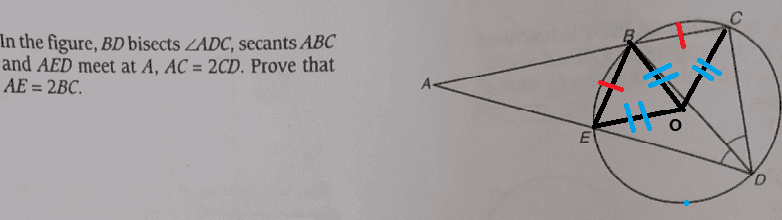

Looking at it again...in my opinion i tend to think the concept being tested on this question is congruency. In answering this question it is paramount to use a given circle property.
Clearly, the textbook has a mistake! The correct statement should have been
Prove ##AB=2BC##.
I agree with @anuttarasammyak .
The textbook problem is solvable.
As he said, you simply need to show that ##\displaystyle \triangle DCA \sim \triangle BEA## . From this you get that ##AE=2EB## .
Also, point ##O## is not necessarily on ##BD## .

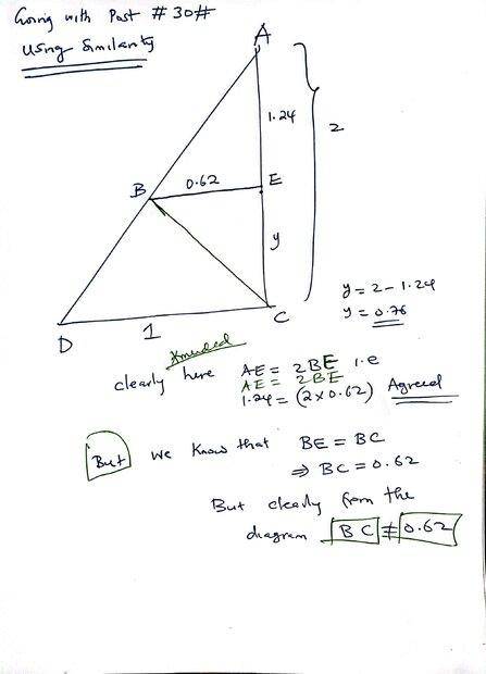

Kindly find my rejoinder...sorry am a bit busy had to scribble my response.
I have made use of similarity (on the diagram) as is suggested...and I still cannot see how ##BC= EB##.

We should prove
[tex]\triangle DCA \sim \triangle BEA[/tex]

Ok then, can you show how ##BC=BE##? Can you draw a sketch of your diagrams separately for clarity.
  • #38
anuttarasammyak said:
I do not need BC=BE for the similarity. Instead, I used equality of two corresponding angles.
This means you're not in agreement with post ##30##. Does the diagram depict the problem? I used it in my analysis.
Is ##BE## equal to ##BC## as indicated?if so, is my analysis correct as shown on post ##33##?
No specific goal or intention.
Just trying to understand the problem, which results interesting to me.
The first drawing was the result of beginning with assumed angles: it did not work.
The second drawing was the result of beginning with the information given in the text of the problem: it worked.
The third drawing is exactly as the second one, only showing the value of the resulting angles with a resolution of 0.00, so @anuttarasammyak could see that those values correspond to the 1:2 proportion of the sides of the triangles.
chwala said:
... are the measurements of ##AE## and## BC## tending towards the envisaged value? Or drifting away...cheers.
AE (1.24 units) is twice as long as BE (0.62 units).
The discontinuos-line circle shows us that the lenghts of BE and BC are exactly the same.
  • #43
I understand that the graphic way is not the way for any student to prove what the problem requires to be proved, as you stated before.
The problem is that I don't know enough math or trigonometry to prove it mathematically.
I hope that my drawings help you gentlemen to find a way to do so, as they prove that the problem is properly stated and that is solvable.

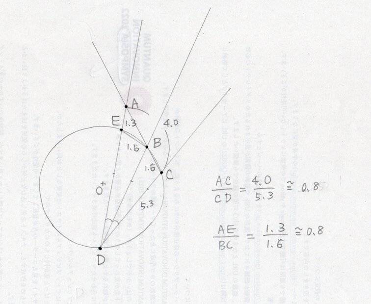

  • #46
Please find below my rough hand drawing of the problem. It happens to be the case of
AC/CD = AE/BC = about 0.8. :wink: O is outside DE.
May I understand that you say the ratio 2 is the special case that O must be on BD ?
  • #47
nice @anuttarasammyak ... looks like after all... ##AE≠2BC##...rather;
From your analysis; ##AE=\dfrac{4}{5}BC##

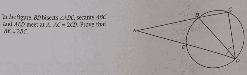

  • #48
May I chip in.
Although the diagram makes BD look like it might be a diameter, there is no reason to assume it is (as I think has already been noted).
Consequently, we can’t assume things like ∠EBD = ∠CBD or that ∠BCD = 90º.
There is nothing wrong with the problem statement.
If you are familiar with certain theorems, the solution is straightforward.
The intersecting secants theorem tells us that:
AB•AC = AE•AD.
The angle bisector theorem tells us that:
AD•BC= CD•AB
We are given AC = 2CD.
Proving that AE=2BC requires only simple algebra using the above equations.
  • #49
The essence of the problem is
[tex]AC/CD=AE/BC[/tex]
coming from same arc lengths and similarity of triangles.
I draw another case which happens to have the ratio of about 2.4 and a procedure to find the case of ratio 2. With fixed B and D, O keeps out of BD.
  • #50
FWIW, I agree with @anuttarasammyak.
BD does not need to be a diameter for the 'similarity' approach to be valid.
This follows from the "Angles of Intersecting Chords Theorem". E.g. see https://www.varsitytutors.com/hotmath/hotmath_help/topics/angle-of-intersecting-chords-theorem
The arc length depends on the angle between the chords.
The angle between DC and DB is the same as the angle between DE and DB. (With E being the point of ‘intersection’ of these 3 chords). If follows that arc length BC = arc length BE.
