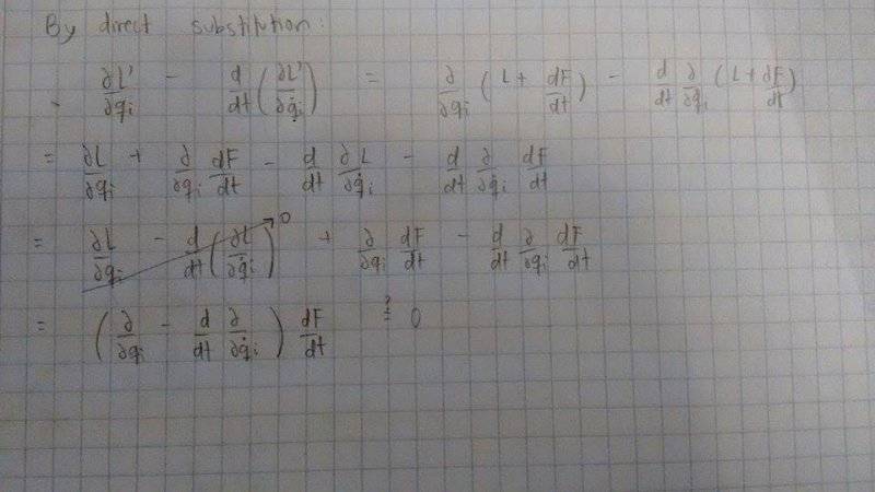

I got that L' satisfies that equation when the derivative for Lagrange's equation of F is 0.
You should probably show your work.
You can use the LaTeX button below to help you typeset your equations.
I don't know how to write LaTeX

Your question is wrong. The function [itex]F[/itex] can not depend on the velocity [itex]\dot{q}(t)[/itex]. If it does, then [itex]d F /d t[/itex] will depend (at least linearly) on the acceleration [itex]\ddot{q}(t)[/itex]. This in turns mean that the two Lagrangians are not equivalent to each other. So, try to solve the exercise for the function [itex]F(t) = F( q(t) , t )[/itex].
This is one part of well know theorem which states
A function [itex]\Lambda[/itex] of [itex]q(t)[/itex], [itex]\dot{q}(t)[/itex] and [itex]t[/itex] satisfies Lagrange’s equations identically (i.e., independent of the [itex]q_{a}(t)[/itex]) if, and only if, it is the total time derivative [itex]d F / dt[/itex] of some function [itex]F ( q(t) , t )[/itex].
