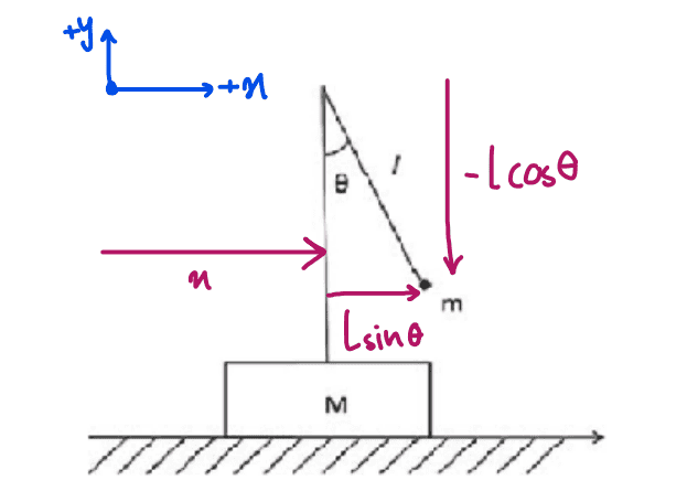

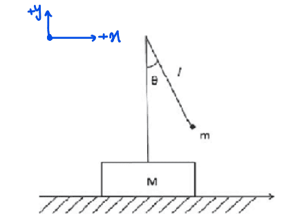

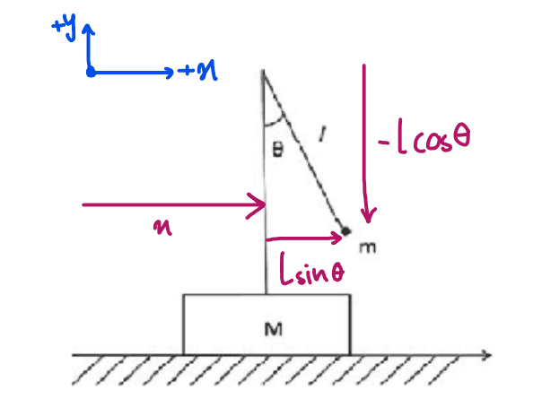

Hello. This is the figure of the problem:
First, we should determine the Lagrangian of the system. I have already completed this part without any issues. To respect everyone’s time, I won’t go into the details of how I accomplished it.
$$L=\dfrac {M+m}{2}\dot x^2+ml\dot x \dot \theta \cos \theta + \dfrac 1 2 m l^2 \dot \theta^2 +mgl\cos \theta $$ To find equation of motion I should directly put the above lagrangian in lagrange's equation? Or is it possible to first simplify it for small oscillations?

I think you would be able to substitute now for ##\cos \theta##
I wanted to simplify it for small oscillations then substitute it in lagrange's equation. But I was not sure. So you don't see a problem in doing this?

Yes, you can expand the Lagrangian for small ##\theta## and then apply the EL equation, but if you want linear EoMs, you need to expand to second order in ##\theta##.

Definitely not!!
PeroK said:
Definitely not!!
Then I should do a lot of math to find its equations of motion, sadly. Thanks, I'll try and post the results soon.
Personally, I prefer to first obtain the equations of motion and then consider approximations only because I don't trust myself not to throw out the baby with the bath water.
Lagrangian of the system is: $$L=\dfrac {M+m}{2}\dot x^2+ml\dot x \dot \theta \cos \theta + \dfrac 1 2 m l^2 \dot \theta^2 +mgl\cos \theta $$
For coordiante ##x## we have:
$$\frac {\partial L} {\partial x}-\frac {d}{dt}\frac {\partial L} {\partial \dot x}=0 $$ $$\frac {\partial L} {\partial \dot x}=A$$ A is a constant. $$(M+m)\dot x+mL\dot \theta cos \theta=A$$$$\dot x = \dfrac {A-ml\dot \theta \cos \theta}{M+m}$$$$x=\dfrac {1}{M+m}(At-ml\sin \theta)$$
I'm not sure with last part. Did I solve for ##x## correctly? Many thanks.

As I said you need to keep terms up to second order in the variable in the Lagrangian to obtain the linearised equations of motion. ##\theta^2## is second order so you cannot ignore it.
One thing to note about your Lagrangian is that it can be easily separated into a translational part and an oscillatory part. This makes the actual problem one-dimensional instead and quite easy to handle.
It doesn't look right. ##\theta## and ##\dot{\theta}## are both functions of time and you don't know what they look like, in fact you are looking for ##\theta(t)##.

This is my attempt at solving the problem. To save time, please skip the calculations. I just need help with the last part because I’m unsure if this method works.
Lagrangian of the system is given by: $$L=\dfrac {M+m}{2}\dot x^2+ml\dot x \dot \theta \cos \theta + \dfrac 1 2 m l^2 \dot \theta^2 +mgl\cos \theta $$ For coordiante ##x## we have: $$\frac {\partial L} {\partial x}-\frac {d}{dt}\frac {\partial L} {\partial \dot x}=0 $$ $$\frac {\partial L} {\partial \dot x}=A$$ A is a constant. $$(M+m)\dot x+ml\dot \theta cos \theta=A$$
For coordiante ##\theta## we have :$$\dfrac {\partial L}{\partial \theta}=-ml \dot x \dot \theta \sin \theta - mgl \sin \theta$$ $$\dfrac {\partial L}{\partial \dot \theta}=ml\dot x \cos \theta+ml^2 \dot \theta$$ $$\frac {d}{dt} \dfrac {\partial L}{\partial \dot \theta}=ml\ddot x \cos \theta -ml\dot x \dot \theta \sin \theta +ml^2 \ddot \theta$$ Using lagrange equation I get: $$-mgl \sin \theta -ml\ddot x \cos \theta - ml^2 \ddot \theta=0$$
I have two equations now: $$(M+m)\dot x+ml\dot \theta cos \theta=A$$$$-g \sin \theta -\ddot x \cos \theta - l \ddot \theta=0$$ Can I find ##\theta (t)## from the second equation and substitute it into the first equation, then solve for ##x(t)##?

What makes you think ##\ddot x = 0 ##?
When I apply conservation of momentum in the ##x## direction I'm not finding that ##\ddot x = 0 ##. Maybe I'm messing that up. What do you get when you apply conservation of momentum?

I'm getting this from conservation of momentum:
$$M \dot x - m( \dot x - l \dot \theta \cos \theta ) = 0 $$
$$ \implies \dot x = -\frac{m}{M-m} l \dot \theta \cos \theta $$
That doesn't seem to be equivalent to your expression?

I think ## \dot x ## is ## \dot x##; if they don't agree, we have a problem.

In the inertial frame the little mass is swinging to the left faster than the large block is moving to the right. Does my approach with the signs make sense to you?
I think that ## m \dot x## should be positive. Because velocity of the mass ##m## is given by its velocity in block M frame + velocity of block M in inertial refrence frame.
Ok, so you are saying with ##\dot \theta < 0 ## we should have this equation:
$$ M \dot x + m( \dot x + m l \dot \theta \cos \theta ) = 0 $$
Which gives:
$$ \dot x = -\frac{ml}{M+m} \dot \theta \cos \theta $$
I can buy that.
