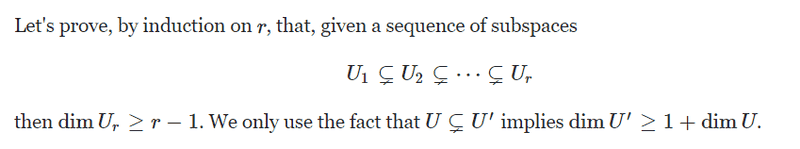

Summary:: I want to understand the following theorem and its proof (which can be found in MSE, link below): Let ##V## be a ##n##-dimensional vector space, let ##U_i \subseteq V## be subspaces of ##V## for ##i = 1,2,\dots,r## where $$U_1 \subseteq U_2 \subseteq \dots \subseteq U_r$$
If ##r>n+1## then there exists an ##i<r## for which ##U_i = U_{i+1}=\dots=U_r##
I understand that if the subspaces were to be strictly contained (i.e. no possibility of equality between them) then, when going from ##U_i## to ##U_{i+1}##, the dimension of the subspace would increase by one. Hence, when reaching ##U_r## the dimension would be greater than ##n+1##. However, this is not possible since ##U_r## is a subspace of ##V## and thus has dimension at most ##n##.
My issues are
1) I do not see why ##\dim U_r>\dim U_i+r-1## follows from the above argument
2) This is related to 1). I do not see why MSE user egreg here assumes non-equality of the subspaces

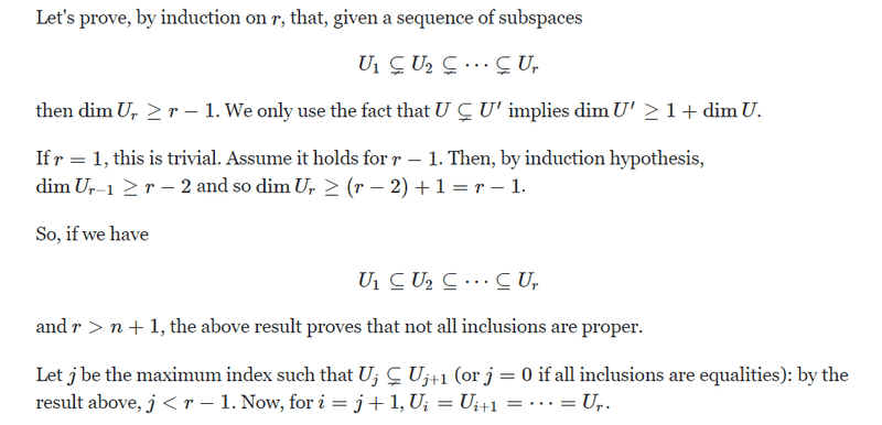

Looks like nonsense to me. ##U_1 = U_2 = \dots = U_{r-1} = \emptyset## and ##U_r = V## is a clear counterexample.
In general, the equalities and strict inclusions could be in any order.
We need some strict inclusions somewhere, e.g. ##U_r\subsetneq V.##
The idea is that you cannot build chains that are longer than the finite dimension of ##V##. If ##U_i\subseteq U_{i+1}## then they are either equal or ##\dim U_{i+1}> \dim U_i##. But we can only use at most ##\dim V## steps. But if everything can be equal, then we could get endless chains with equalities.
One could say: Every chain ##U_1\subseteq \ldots \subseteq U_r\subseteq \ldots## becomes stationary, i.e. there is an index ##r## such that ##U_p=U_r## for all ##p>r.##

##V = \mathbb{R^3}, \ U_1 = U_2 = U_3 = \mathbb{R}, U_4 = \mathbb{R^2}, \ U_5 = \mathbb{R^3}##
So: ##n = 3, r = 5## and your proposition fails, as there is no ##i < r## for which ##U_i = U_r##.
The "proof" is nonsense, as the proposition is clearly false.

Ahhh I see the misunderstanding! :) I should have written ##U_i = U_{i+1}## instead of ##U_i = U_{i+1}=\dots=U_r## in the original statement. For the sake of clarity, let me state the theorem again
Let ##V## be a ##n##-dimensional vector space, let ##U_i \subset V## be subspaces of ##V## for ##i = 1,2,\dots,r## where $$U_1 \subset U_2 \subset \dots \subset U_r$$
If ##r>n+1## then there exists an ##i<r## for which ##U_i = U_{i+1}##
Your counterexample does not apply now as , for instance, we have ##U_2 = U_3##.

The proof would be simplified, it seems to me, by first showing that ##d_1 \le d_2 \dots \le d_r##, where ##d_i## is the dimension of ##U_i##.
Then, given that there are only ##n+1## integers from ##0## to ##n## inclusive, if ##r > n+1##, then we cannot have strict inequalities all along the line (do you really need to prove this formally?). So, we must have at least one ##i < r##, such that ##d_i = d_{i+1}##.
Then, show that this implies ##U_i = U_{i+1}##.

What we want to prove: If ##r>n+1## then there exists an ##i<r## for which ##U_i = U_{i+1}##.
Approach to prove it: contradiction. We assume that if ##r > n+1## then ##\forall i < r## we have ##U_i \neq U_{i + 1}## (in other words, we assume all inclusions to be strict).
As I was taught during lectures, we define the trivial vectorspace ##\{ 0 \}## to have dimension zero. This implies that ##\dim U_1 \geq 0##.
Let us look at ##U_1\subsetneq U_2##.
During lectures I learned a theorem stating that given a ##n-##dimensional vectorspace ##(\Bbb R, V, +)## and a finite subspace ##U## it holds that ##\dim U \leq \dim V##. Hence, taking into account that we deal with strict inclusions, it follows that ##\dim U_2 > \dim U_1 \geq 0##. Actually ##U_2## contains (at least) a non-trivial natural number i.e. any ##x \in \mathbb{N} \setminus \{ 0\} ##. It follows that ##\dim U_2 \geq 1##.
It follows that for ##U_2\subsetneq U_3## we get ##\dim U_3 \geq 2 = 3 - 1## and the pattern yields ##\dim U_r \geq r - 1##. We are given that ##r > n+1## so it follows that ##\dim U_r \geq r - 1 > n + 1 - 1 = n ## i.e. ##\dim U_r > n ##
"AJÁ", CONTRADICTION! Based on the theorem I stated above, we require the dimension of the vectorspace ##V## and the subspace ##U## to satisfy ##\dim U \leq \dim V##

This is correct, except that it is a different statement. You have proven that there cannot be more than ##n+1## strict inclusions in a chain of length ##n+1##.
I have claimed, that regardless of how many equalities we have, or do not have, there will be some index form which on there are only equalities left. And note, that I haven't used any dimension in the statement, nor that the chain ends with ##V.##
However, you can prove my statement with yours.
