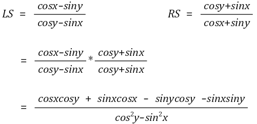

Prove that LS=RS.

if LHS=RHS, then:
[tex](\cos x-\sin y)(\cos x+\sin y)=(\cos y+\sin x)(\cos y-\sin x)[/tex]
... right?
So why not expand it out and look for the usual identities?

According to my teacher/school (I'm from Ontario), you're not allowed to work on both sides like that. You have to work on each side independent from the other. Why? I have no idea why... :(
edit: My teacher says you can't do that, because we don't know if LS=RS. We're trying to see if LS=RS by proving it.

Regarding your first post in this thread: do NOT multiply out the numerators. Leave them in factored form. So you have this:
[tex]\frac{(\cos x - \sin y)(\cos y + \sin x)}{cos^2 y - sin^2 x}[/tex]
Now use the Pythagorean identities to rewrite BOTH terms in the denominator.
If you figure this out, you'll probably ask, how did I know NOT to multiply out the numerator? I noticed that when you multiplied top and bottom by (cos y + sin x), that is also the numerator of the RHS. You'll see what happens by leaving the numerator in factored form.

Amazing! I feel so happy solving these. After that, I noticed that the denominator was a difference of square, and I canceled out the factors.

If LHS=RHS then I can propose (what I did) - and attempt to disprove it. If the proposition is false, then surely the equation will yield an inconsistency like 2=3? Of course, not all will reduce easily.
You could then start by putting both sides over a common denominator ... then you only have to prove the numerators are the same. This will be mathematically equivalent to the above approach.
