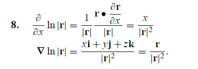

  • Printed problem 8: Calculate V ln |r|, where r = xi + yj + zk.

  • Handwritten-style derivation of partial x of ln|r| equals x over |r| squared, and the gradient of ln|r| equals r over |r| squared, using r dot i over |r| and the partial derivative of r with respect to x.
