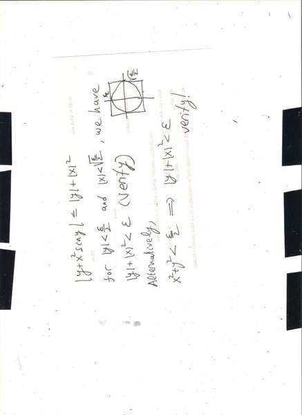

show that $$f(x,y) =y+x^2cosy $$ has a limit 0 at (0,0) by the ε-δ definition.
$$|y+x^2cosy| ≤ |y|+|x^2|$$ (by tri. inequ. and $$|cosy|≤1$$
then can I suppose $$|x^2|<|x|$$ , since $$|x|<1$$,
then $$|y+x^2cosy| ≤ |x|+|y| ≤ 2\sqrt{x^2+y^2} $$ ?
if not , how can I do it by the ε-δ definition
Attached
Given [itex]\epsilon> 0[/itex], show that there exist [itex]\delta> 0[/itex] such that if [itex]\sqrt{x^2+ y^2}< \delta[/itex] (this is the distance from (x, y) to (0, 0)) then [itex]|y+ x^2cos(y)|<\epsilon[/itex].
From your last inequality, [itex]|y+ x^2cos(y)|< 2\sqrt{x^2+ y^2}[/itex] you just need to choose [itex]\delta< \epsilon/2[/itex].
thanks you guys, actually I would want to know can I suppose x^2|<|x| , since |x|<1
Hmm depends on how small you want your neighborhood to be in terms of your choice of δ.
Otherwise you can assume that |x| ≤ (x2+y2)1/2 < δ and |y| ≤ (x2+y2)1/2 < δ
So that : [itex]|y| + |x|^2 < δ + δ^2 = δ(δ+1)[/itex] Then for δ≤1, we would have :
[itex]|y| + |x|^2 < δ + δ^2 = δ(δ+1) ≤ 2δ ≤ ε[/itex]
So as long as δ ≤ min{1, ε/2} you're good.
