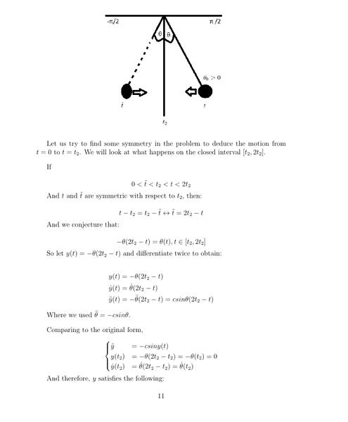

I'm writing a small project as part of my degree, and I am stuck on proving one (probably simple!) thing towards the end. I've shown that the pendulum is periodic and has a total period of 4t2.
[/B]
I think I need to rewrite the same ODE with starting point t=0 but I'm having a complete mindblank on how to proceed from here. Any help would be greatly appreciated!

Sorry I should've given more information. The equation I'm drawing on as is as you said is ##\ddot\theta = -csin\theta## and this is just the regular sine function multiplied by a constant, c. No complex sine - sorry for the confusion.[PLAIN][PLAIN]http://blob:http://imgur.com/d719fbec-3e87-4f2c-a28f-955630eb054a [PLAIN][PLAIN]http://blob:http://imgur.com/d719fbec-3e87-4f2c-a28f-955630eb054a [PLAIN][PLAIN]http://blob:http://imgur.com/d719fbec-3e87-4f2c-a28f-955630eb054a [PLAIN][PLAIN]http://blob:http://imgur.com/d719fbec-3e87-4f2c-a28f-955630eb054a
Here is everything I know that's relevant to periodicity in my paper. Thanks for your reply!

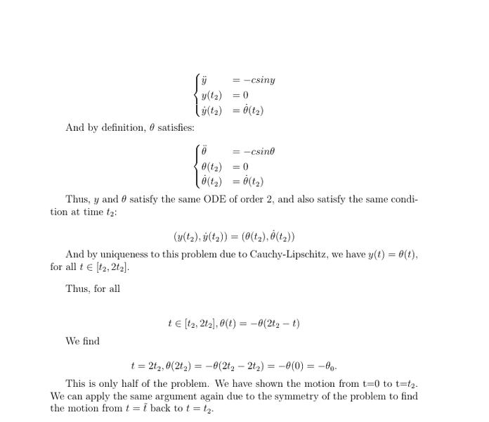

As far as I can see, nowhere did you define the initial conditions (t=0). But in the second stage (post #1) you use ##\dot\theta(0)=0##.
You have an equation ##\theta(t)=-\theta(4t_2-t)##.
What would that imply at t=2t2? Is the minus sign a mistake?

The minus sign is a typo, thanks for pointing that out!

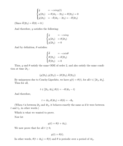

At time t=2t2, we have that it's equal to ##\theta(-t)## by symmetry, since it's the furthest "left" position of the mass (taking moving from left to right as being negative).
I think I need to prove that ##\theta(4t_2) = \theta(0)## but I'm not entirely sure... I think to do that I would need to basically run through a very similar argument again and then use cauchy-lipschitz to show uniqueness
You need to show that the initial conditions going forward from 4t2 are the same as those going forward from t=0. So that's the values of ##\theta## and ##\dot\theta##.

So in short I need to show that ##\theta(0) = \theta(4t_2)## and that ##\dot\theta(0) = \dot\theta(4t_2)##? And then use a similar argument from before, from my second post with:
$$\begin{cases}
\ddot y& = -csiny(t)\\
y(t_2)&=-\theta(2t_2-t_2)=-\theta(t_2)=0 \\
\dot y(t_2)&=\dot\theta(2t_2-t_2)=\dot\theta(t_2)
\end{cases}$$
Or am I way off?
And then I would need to change this to reflect 0 and ##4t_2##?
$$-\theta(2t_2-t)=\theta(t), t\in[t_2, 2t_2]$$
Yes.
As you wish, but to me it would be suffice to say that the values of ##\theta## and ##\dot\theta## define the state of the system, so if the value pair recurs then the behaviour is cyclic. Likewise, for your antisymmetric result in post #3, I would just observe the effect of time reversal on the differential equation.
