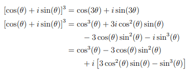

Binomial theorem
Why when proving trig identities,
Do we assume that r = 1 from ## rcis\theta = r[\cos\theta + i\sin\theta]##? This makes me think that this is somehow it is related the unit circle.
Note: I am trying to prove the ##cos3\theta## identity and am curious why we assume that the modulus is 1.
Many thanks!
No.
But the problem you posted doesn't include r. It is a proof of the identity ##(\cos(\theta) + i
\sin(\theta))^3 = \cos(3\theta) + i\sin(3\theta)##.

I am wondering whether the identity can be proved in general for any r. That is, if we let
##(r[\cos(\theta) + i\sin(\theta)])^3##.
EDIT: I believe it would work, but why?
Many thanks!

You basically need to understand where those identities come from ##z^n + \dfrac{1}{z^n} = 2 \cos (n\theta)## in your (now) closed thread https://www.physicsforums.com/threads/another-way-to-find-trig-identities.1050812/
Here is a guide you can follow to prove the identity above.
1) any complex number ##z## where ##|z| = 1## can by definition be written as ##\cos \theta + \mathrm{i} \sin \theta##.
2) ##z^n = \cos (n\theta) + \mathrm{i} \sin (n\theta)## where ##n## is a positive integer. This one is pretty simple to prove, you have probably done so in class. Otherwise, it is pretty simple to show using a proof by induction, e.g. show that if ##z^p = \cos (p\theta) + \mathrm{i} \sin (p\theta)## where ##p## is a positive integer, then show the following also holds: ##z^{p+1} = \cos ((p+1)\theta) + \mathrm{i} \sin ((p+1)\theta)##
3) Next things to understand, is that ##\dfrac{1}{z^n} = \cos (-n\theta) + \mathrm{i} \sin (-n\theta)## for ##n## any integer, positive or negative (and 0 of course). This is also pretty simple to show. Use that cos is even function and that sin is odd function. Then show that this indeed is equal to ##\dfrac{1}{z^n}##.
4) Now you are almost there. Should be straightforward to show that ##z^n + \dfrac{1}{z^n} = 2 \cos (n\theta)## at this point.
Yes, it is. ##[\cos(\theta) + i \sin(\theta)]^3 = [e^{i \theta}]^3##. Now use the properties of exponents and put it back into the cos(), i sin() form.

Sorry never mind. I think I understand now.
##[e^{i\theta}]^3 = e^{3\theta i}## which from the definition of Euler's formula gives
##\cos3\theta + i\sin3\theta## interesting that we don't have to use de moiré's theorem.Many thanks!
