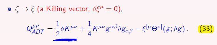

There is something wrong with your reply, maybe the reason is I don't explain it clear. h_{a b}≠0. If you want to know more, please refer to arXiv:1306.2138[hep-th]. the 1st equation in the last page.

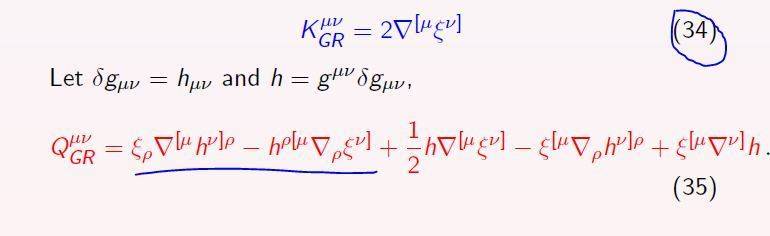

we will start from the equation(15), we get Neother potential ##K^{\mu \nu}##, and in the Einstein Gravity, ##K^{\mu \nu} = 2*\nabla^{[\mu}*\xi^{\nu]}##. Then we will get the ADT potential(equation(16)). The first term of (16) is ##\delta K^{\mu \nu}##. Substituting ##K^{\mu \nu} = 2*\nabla^{[\mu}*\xi^{\nu]}## into it, the result is the sum of the 1st and 2nd terms of the 1st equation in page 4.
The case of Einstein gravity is just an simple example to calculate the conserve charge, but I can't get it.
You are right. ##\zeta^{^a}## is a diffeomorphism. And under the diffeomorphism we get the conserved current(equation (3)). And as the paper says "In order to see the relation of the off-shell current for the diffeomorphism to the linearized conserved current for a Killing vector , it is useful to consider the change in the Noether potential under the variation of the metric which preserves the Killing vector ##\delta \xi^a = 0##".
The core of the problem is variation of ##K^{\mu \nu}## with respect metric with assuming ##\delta \xi^a = 0##.

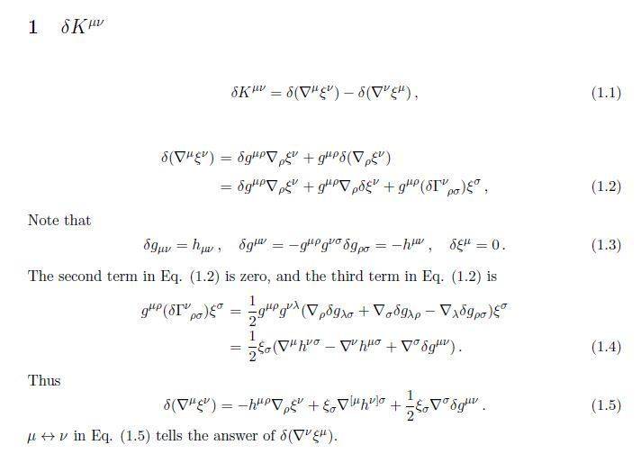

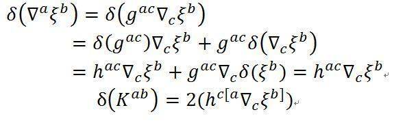

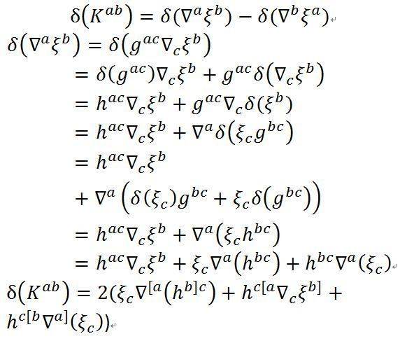

The attachment is my derivation process. the 1st is with assuming ##\delta \xi_a = 0##. The 2nd is with assuming ##\delta \xi^a = 0##. Both of them I can't get the result, so I think maybe I make some mistakes. But I can't find where I am wrong. Please help me, thanks!

I have got the right answer from my senior fellow apprentice. It is in the attachment. Whatever thank you very much!
Cool, and thanks for providing the final calculation as well! I'm sorry I wasn't able to reply to you sooner. I was actually calculating ##\delta K^{ab} = \delta (\nabla^a \xi^b) = \delta (\nabla^{[a}\xi^{b]})## under ##\delta g_{ab} = 2\nabla_{(a}\zeta_{b)}## in the exact same way you did using ##\delta \xi^a =0## and got stuck in the same place that you did as well. I didn't even think about expanding ##\nabla^a \xi^b## out in terms of ##\Gamma^a_{bc}## and considering ##\delta \Gamma^a _{bc}## haha.
