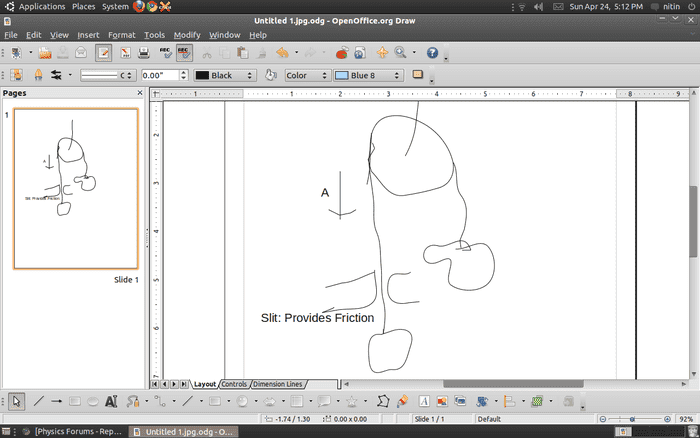

Okay. Consider this. There is a slit through which the string passes and slit provides friction. is tension same on both sides of pulley? Is tension same on both sides of slit?Consider this. there is no block on one side of pulley. Is there tension on string now?
What is providing centripetal acceleration required by string to move in circular path??Consider this: There is two blocks on one side of a pulley, connected in series and one block on other side. is tension same on both sides of pulley and between the two blocks on one side?
Sorry, but I don't understand what you mean.
If I understand you correctly, no.
The string is treated as massless.
Yes, if the pulley is massless and frictionless.
No. The rope segment between those two blocks will have a different tension than the other rope segment.

About the slit? If it provides friction, then the tension will be different on each side of the slit.
Can you please explain how?
How much friction does the slit exert?
10N. Or take it as unknown if you want it that way.
If the force required to overcome friction is 10N, then that's the difference in tension across the slit.
