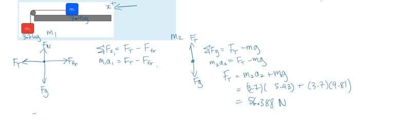

Two blocks of the masses m1=7.40 kg and m2=m1/2 are connected via a massless pulley and massless string. The system is currently in equilibrium but is about to start sliding, if m2 would increase even by a bit. For the friction between the surface and m1 assume that µs=µk. The block m2 is suspended from the pulley and is free to swing. What will be the acceleration of m1 if the surface starts to move in a horizontal direction to the right with an acceleration a=5.43 m/s2? Take +x direction to be toward the left. Give your answer in m/s2.
F=ma
For m1
ΣFx=FT
m1a1=FT
For m2
ΣFy=FT-mg
m2a2=FT-mg
I am not sure how to use the given acceleration in the problem. Also, does µs=µk mean there is no friction?If anyone could help me with this, I would be grateful.

This is what I have so far. Since the accelerations are the same then why do we have to calculate to find the acceleration of mass 1? Do we have to account for friction? How would I proceed based on what I have written down?
Which accelerations are the same? There are the three horizontal accelerations of the surface and the two masses, and the vertical acceleration of the suspended mass.
So are the net accelerations of the 2 masses the same? and does friction matter in this case?
No.
Start with the horizontal acceleration of the hanging mass. Can you say what that is? Consider the forces on it.
Next, consider that the string length is constant. What does that tell you about the relationship between the other three accelerations?

So is the horizontal acceleration of the hanging mass -5.43? Is that the only place where the 5.43 applies?

Why would it be that? What forces act on it?

Well the force of the surface moving, force of tension upwards, and force due to gravity downwards? Am I missing something?

How does the hanging mass know the surface is accelerating?

It moves rightwards as the surface moves rightwards?

If it "knew" that the surface was moving rightward, it might move rightward. How would it "know"?

So does that mean there is no horizontal acceleration for the hanging mass?

If you draw a free body diagram, what forces on the hanging mass have non-zero horizontal components?

Gravity and tension force. So what does this tell me in terms of the question?

Certainly not. That is the horizontal acceleration of the surface. What have you concluded from the above about the horizontal acceleration of the suspended mass?

You are only asked about the immediate accelerations. There has been no time for the angle to change.

If you answer the question I posed at the start of post #2 and again at the end of post #6 you will find out.

So since the string has a constant length, the magnitude of a(m2)=a(m1), right?

Remember that the surface, including the pulley, is accelerating.

As I read it, the acceleration of the surface is imposed by some external force.

So what do we do about friction?
