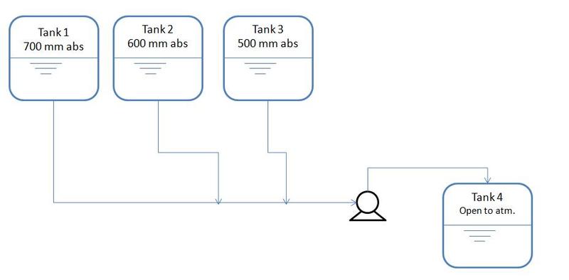

Is it possible to pump out water from three tanks all under a different vacuum level using a common pump and common suction header? Or would this arrangement cause problems? The destination is a single tank at atmospheric pressure.
See Sketch below.
I'm trying to intuitively figure how the pressure profile in the piping would look like.
Flow rates? Line lengths and sizes?
Tanks are all next to each other. Line length is approx. 100 ft total from anyone vacuum tank till the atm tank. Where to keep pump etc. is flexible. All three vacuum tanks are elevated approximately 10 feet above the atmospheric tank.
Flow rates are low; approx. 500 Litres/hr from each tank. Line size is flexible too but I was thinking 1/2 inch would be generous.
Basically, three condensate accumulations have to be emptied out & I was wondering if I could do with one pump instead of three separate ones.
Check valves on the exit lines? One and two are going to be self-draining, and three is the only one that will require pumping.
Makes sense thanks.
Out of curiosity what if the vacuum levels were stronger. i.e. none of the tanks were self draining. Would this pumping scheme work then?
Say assume 300, 200, 100 mmHg?
I'm always hesitant to count on a gravity head for draining. That's why a pump would give me a margin of safety. But what I worry hear is a higher vacuum tank pulling from another via the interconnections.
How bad do things get if you get backflow into your process/condensate lines feeding these tanks?
Not very bad. It won't be a disaster if there's any intermittent cross contamination.
So long as, on average, in the long run I can stabilize the system without any inter-flows.

What stops the three source tanks trying to equalise their pressures?
