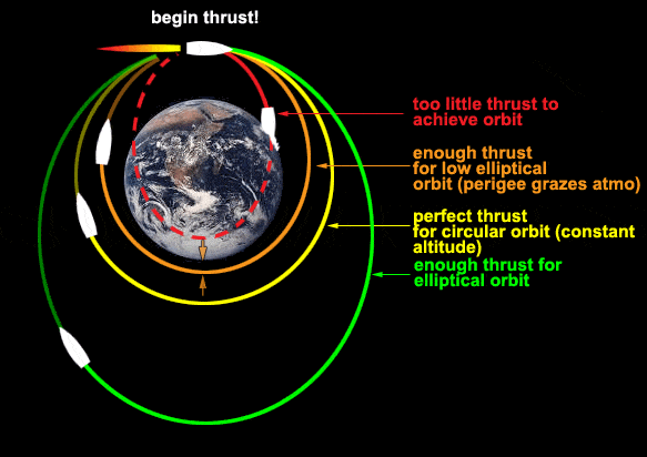

Geez it's been ages since I last was here. Anyway, I was thinking a little on the subject below and remembered this place. It's probably ridiculously trivial, but still I wonder:
A satellite stays in orbit around the Earth because it's falling at the same pace as the Earth's surface curves, simply put. But that's a sattelite in stationary orbit. What happens if I release a sattelite in an orbit that's to high for it's speed? My guess: it falls back to Earth and because it's angular momentum needs to be preserved it gradually picks up more tangential speed until it lands into a stationary orbit, which would be somewhere between the orbit where it should've been and where it was released...
Correct or rubbish? :redface:
You've put it in an elliptical orbit. Its apogee (maximum altitude) is where you released it, its perigee (minimum altitude) will be where it is closest to the Earth (but moving fastest). Provided the perigee is still above Earth's atmospheric drag, it will remain in that stable, elliptical orbit.

I think the term you are looking for is stable orbit. Unless acted upon by an outside force (such as another gravitational body, or friction) (or, an inside force such as rockets), a satellite will remain in a stable elliptical orbit. Period. This is critical to your understanding of orbits.
Now, if you play with the adjustments carefully, you can get the satellite's orbit to have virtually zero eccentricity, meaning its orbit is circular, and meaning that it will move around while maintaining a constant altitude above the Earth.
Look at the attached illo.
