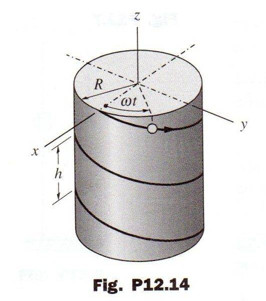

When a particle moves along the helix shown, the componentsof its position vector are
x=Rcosωt , y = Rsinωt , ##z=-\frac h {2π} ωt##
where ω is constant. Show that the velocity and acceleration have constant magnitutes,
and compute their values if R=1.2m, h=0.75m, and ω=4π rad/s
for a start I would like someone to tell me by computing vz = dz/dhxdh/dt
what dh/dt is equal to? Since h = 0.75m = constant, then vz=0 and az = 0
Is my asumption correct?

You would not take a derivative with respect to h : h and R are parameters which someone would choose to describe a specific shape and size of helix. Imagine a tightly wound screw, then you have h (the gap between adjacent helix "threads") small in relation to R. If h is larger then it will be a "shallower" spiral (imagine a drill bit). so h and R are considered constants, in this case.

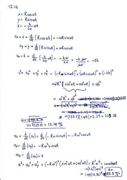

Can you chek my solution?
My results are the same as Pytels
  • Handwritten solution to problem 12.14: helix parametric equations x = R cos wt, y = R sin wt, z = -h/(2n) wt, followed by velocity components, speed squared, and acceleration components leading to a constant magnitude.
It looks right to me. I didn't get out the calculator and check all the numbers. They appear to be in the ballpark, though.
One thing: I would keep the units when doing the work. You made the substitution of w = 4pi and then canceled out the pi, so that vz = -2h ; which when first looking at it, looks like a distance, not a velocity. But the w carried a dimension of (1/time), which would restore the [Length]/[Time] dimensions of velocity. (radian angle measure is considered dimensionless in most cases.
