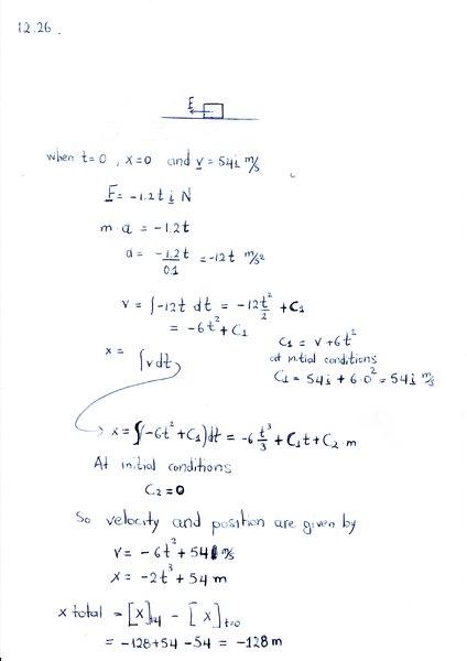

A 0.1-kg block moves along the x-axis. The resultant of all forces acting on the block is F = -1.2tiN, where t
is in seconds. When t=0, x=0 and v=54i m/s.
Determine the distance traveled by the particle during the time interval t=0 to t=4s.
See the attached file.
Also, when do I use vector notation in the equations? Is it my choice whether to use it or not?
What does the minus sign in the solution result mean?
Next problem is with better pen.

The x(t) function is wrong.
The problem asks the distance traveled. It is not the same as the displacement, x(final)-x(initial).
The book gives a result of 128m.
Basicallly I am confused on how to calculate this. Do I calculate the position at every second (from 0 to 4 seconds) and then...?
Also x(t) should be ##x(t)=-2t^3+54t##
By looking the graph of the function when v=0 then t=3 and could be easily calculated.
At t=3s then x=108m. At t=4s then x=88m.
So the block had traveled from t=0s to t=3s to the right for 108m and then from t=3s to t=4s to the left for 20m. So distance travelled
from t=0s to t=4s is 128m.
How do I calculate this by using a formula?

The distance traveled is the integral of the speed with respect to time. The speed is magnitude of the velocity ##v=|\vec v|##. The velocity changes sign at t = 3 s, so ##d=\int _0^3(-6t^2+54)dt+\int _3^4(6t^2-54)dt##
Likes Alexanddros81
Yes. I've done the math and works fine. 108 from forst integral and 20 from second.
