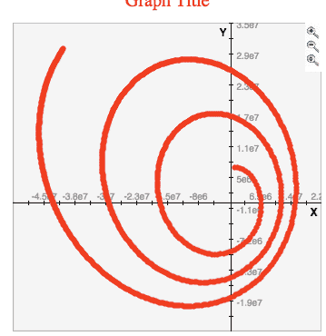

I'm writing something in python that takes in an apple's initial position vector and initial velocity vector, and for a given gravitational field due to a planet, returns the next position vector after a small time increment, until the apple crashes into the planet's surface and the program halts (or the apple flies off to infinity and the user halts it.)

I get lists of position vectors at the end of this process which I can plot (I can't work out how to get excel to plot my ordered pairs so I have been reduced to using an online tool!). I include one for your examination. (Just to be clear, it begins at the point (0, 7million) and spirals out clockwise.)
The problem is that the apple seems to violate energy conservation: it always flies off to infinity. No matter how carefully I set the velocity to the critical value for circular motion at the beginning, it always spirals out like below. Even when the initial velocity is a little less than what would be required for circular motion.

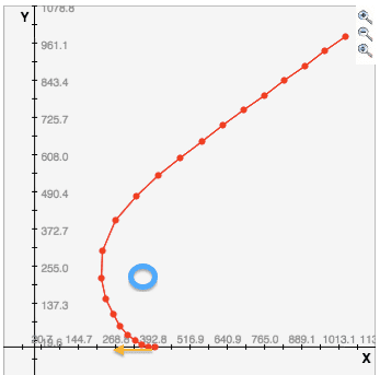

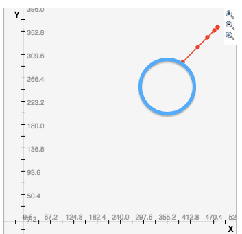

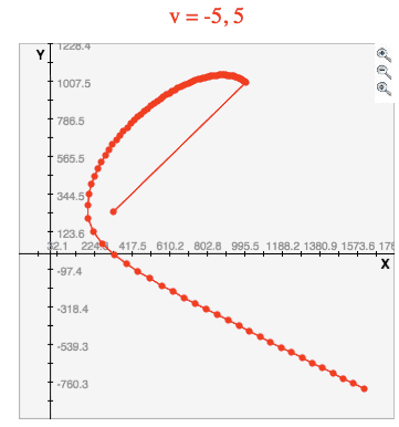

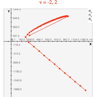

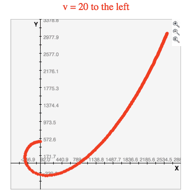

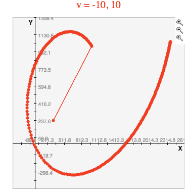

I thought I might add some more pictures. These are from an older version of the code, calibrated differently (in all but one, the planet is not centred on (0, 0), and some have different values for G, M and deltat). But I was having essentially the same problem. Also apologies for the ad-hoc way they're labeled (or not labeled).
Plot of a red trajectory with markers connecting points, curving from the top right down and around to the left and then back toward the lower right, with X axis from about 30 to 1113 and Y axis from about 30 to 1078.8, and a small blue ring near the centre.
Plot of a curved trajectory on X and Y axes, starting near the origin and looping to the left before sweeping up and to the right. The title above reads v = 20 to the left.
this 0 initial velocity case went ok:
Plot of a blue circle with a red line of dots extending from its edge toward the upper right, on axes labelled X and Y with tick values from about 0 to 520 and 50 to 396.
Plot of a trajectory with X and Y axes; a dotted red path starts at the upper left, curves to the right near the top, and a second path runs from a point near the origin down to the lower right. Title reads v = -2, 2.
Plot of a sequence of dots tracing a curve in X and Y axes: a loop bending from a point near (0, 300) up to about y=1000 and back, with a straight line segment joining the last dot to a separate point, and a second arc falling steeply to lower right beneath the axis. Title reads v = -5, 5.
Plot of a red dotted trajectory on X and Y axes, starting near the origin and curving in a loop; a red line connects the trajectory's start point to a point on its path.

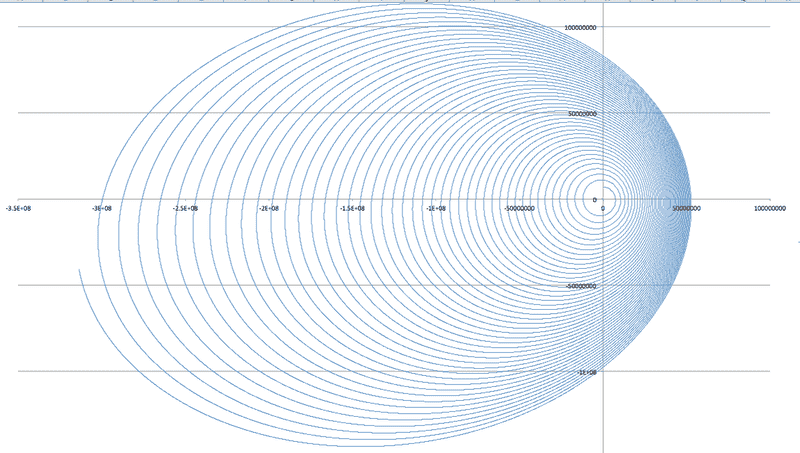

However the problem is still the gradual increase in tangential velocity that causes the apple to deviate from circular motion. Could this be due to computer rounding errors? Please see the most recent attached picture.
Note that in the apple begins near the centre and spirals outwards, clockwise. It began with the critical velocity for circular motion, accurate to 6 decimal places.
Plot of a spiral-like orbit drawn in blue on Cartesian axes, starting near the origin and expanding outward into a large elongated shape, with x-axis labels from -3.5E+08 to 100000000 and y-axis labels from -100000000 to 100000000.

Thanks for the help - I also posted on physics stack exchange and the community told me my problem was most likely due to my use of the Forward Euler numerical integration method (unbeknownst to me!) and that such a method is prone to large errors. They suggested either a Runge-Kutta method which is still prone to (smaller) errors, 'sympletic' integration, or some heuristic method of 'correcting' the magnitude of velocity at each step such that the sum of KE and GPE doesn't exceed it's initial value at the start of the process.
