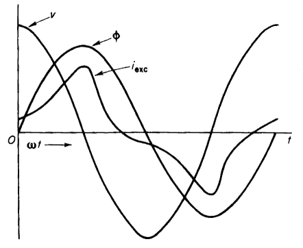

let's just focus on the magnetization graph I posted above. Why is sin wave voltage across a coil inducing a perfect sin wave flux? shouldn't both current and flux be skewed by the hysterisis and saturation? I don't think this is how the 4th maxwell equation is applied. And I don't think the 3rd equation can be reversed either
There is no way of knowing from the graph alone - where did you get it from?
I note that there are three curves, only one looks like a good sine wave... that is labelled with a phi.
Probably flux. The other two are V (a voltage maybe) and and iexC (some sort of current). These don't look like nice sine waves at all - though the V curve is sort-of sinusoidal.
I would guess that the flux was applied and the other two curves are calculated from that, taking into account... pretty much whatever the author wanted to.

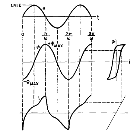

I really really appreciate all of your time and effort to understand my concern and answering. This is brilliant.
My bad for not structuring my scenario clear, so here is the whole setup:
the circuit is simply a SinWave voltage source (ideal) connected to a single coil with an closed iron core inside. It would like the picture below while ignore the labels.
Only consider saturation and hysteresis of the core and assuming no resistance and no eddie current of core loss or leakage. the relation between the voltage of the source, the current in the coils and the flux will look like this:
SO many textbooks just say:" Farady said v = dø/dt, so if v is sin(something) then ø is cos(something), right there, and done". I was like WTF, that's the induced voltage from a driving flux. Flux has nothing to do with voltage. flux is the result of current: line integral H*L = i. the E inside Maxwell's 4th equation in this case means the E inside of the wires. and H it generated around the winding... OK...that apparently does imply a relationship of V_magnetizing = d( flux_result ) / dt... I just confused myself. I thought 4th equation does not apply here, but apparently it does apply inside the winding wires.
but... what about the current side of the story, the current flowing in the wires, that will get some H going around the winding wires as well.
Some one please help me to apply maxwell 4th equation in this scenario.
