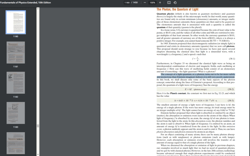

I desire deeper understanding of fundamental physics, and quantum mechanics can be a challenge for me (compared to other topics in physics).
I read in the intro of the physics textbook chapter that QM explains many phenomena, e.g. why copper conducts electricity and glass does not. In same chapter the authors explain the concept of a photon for light, but also state that the concept of the photon is still "poorly understood."
Is that still true today? The concept of a photon still a bit of a mystery?

Perhaps you can tell us the name & author of the book, so we know (and everyone reading here) to avoid it.
The year of publication might be valuable too. If it's a century old...
"The concept of a light quantum, or a photon, turns out to be far more subtle and mysterious than einstein imagined. Indeed, it is still very poorly understood." - Halliday/Resnick/Walker Chapter 39 of 6th edition "Fundamentals of Physics". Published in 2001.
That reading sparked by post to PF today.
@CPW , You can drop that wrong statement from reading. This is a general level physics textbook. It should not contain such absurd exaggerations.

Argh, one more book I thought useful, which you can't recommend anymore. The irony is that the work Einstein got his Nobel prize for is the only one which is completely obsolete today, known as "the old quantum theory" with all the mysterious properties like wave-particle dualism etc. His works on relativity (classical part) and statistical physics are, of course, valid today. It's amusing that Einstein's Nobel certificate explicitly says that the prize was not (!) given for relativity, which was due to some philosophical dispute dominated by a then famous philosopher Bergson, who thought that the relativsitic notion of time was flawed ;-)).
Today we exclusively use "modern quantum theory", which has been discovered almost at the same time (1925-1926) in three formulations: "matrix mechanics" (suggested by Heisenberg, worked out by Born, Jordan, and Heisenberg in 1925), "wave mechanics" (Schrödinger 1926), and "transformation theory" (Dirac 1926). Born and Jordan had already in 1926 also the idea of field quantization, applied to the electromagnetic field, but this was overlooked for some time and had to be rediscovered by Dirac in 1927.
Unfortunately the introductory chapters of textbooks still use the old wave-particle dualism and the wrong picture of photons as "light particles" of the old quantum theory, which regularly leads to confusion. The problem with that approach is that you have unlearn these claims again when going on to study the now established modern quantum theory.
Photons are the least particle-like entities of the entire business. The reason is that they have to be described as massless fields with spin 1 within relativistic quantum field theory. This implies that that they do not even admit the definition of a proper position operator, i.e., it doesn't make sense to talk about "point particles" in the context of photons from very basic principles. Thus photons are not only not localizable but you cannot even really define what "localizable" in a strict sense should mean.
A much better intuitive picture is to think of photons in terms of electromagnetic waves, known from classical electrodynamics since Maxwell's and Hertz's works in the 19th century. The only "particle-like aspect" is that a single-photon must be understood as a specific state of the quantized electromagnetic field, where strictly only one quantum of this field is present. This implies that you can detect only the "entire photon" or "nothing" at a certain place and time, where the place is determined by the location of the photon detector (e.g., a CCD camera or a photo plate). From the fundamental theory of the interaction of the em. field with charged particles you find out that the detection probability at a certain place and time is proportional to the energy density of the electromagnetic field, and that's all you can know about the photon (plus the probability for a given polarization state, if this is also measured).
Don't be ridiculous. Either it is a good book for its target audience, which is consistent in its own ways. Or it is suboptimal for its target audience, for whatever reasons. One or two wrong statements, or even an entirely wrong chapter will not fundamentally change this. And students have to develop some mechanisms for dealing with wrong or inaccurate statements in textbooks anyway.

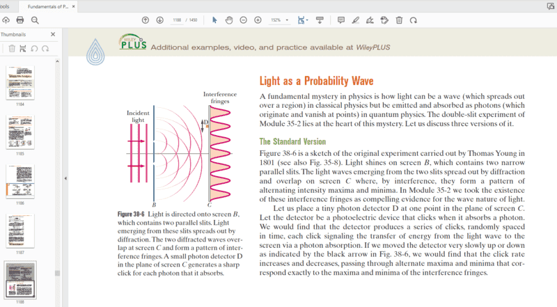

This is from the 10th edition and 2015 not the 6th and 2001, its still in that one. Light is a probability wave, made up of a discrete and quantifiable amount of particles, we call them photons. Like you can't have 1/2 or 1/4 of a human, but you still see it all the time in statistics, you can't have 1/2 or 1/4 of a photon. The concept of a photon is the easy part to understand, its the Schrödinger wave function(basic rule #2) and Heisenberg uncertainty principle (Von Neumann projection, basic rule #7) that expands or collapses the wave function that is the strange part. It is usually best to just look at the math, and Feynman diagrams.
Don't use this book. It's entirely misleading. There is no other way to understand photons than to learn relativistic QFT.
The textbook you referenced does not say this. It does say what the OP quoted in post #7 (you highlighted that sentence), which is not accurate for the reasons that have been given. But when talking about what is inaccurate or incomplete in the textbook, we should be talking about what it actually says.
No, it actually describes light as a probability wave, that's why I said it. Just 8 pages past the one with the quote from OP. Then describes experiments that explain this wave-particle view.
In a different place than you quoted before, yes. In this particular case, though, the "wave" is simply the same wave that appears in the classical analysis, just reinterpreted as the probability of getting a click in the photon detector. There is no need to view the individual photons as following trajectories through spacetime--unless you want to take the Feynman "sum over histories" view and say that the "photon" follows all of the possible trajectories through spacetime from source to detector, with each trajectory contributing to the total amplitude. In which case you've discarded the original "particle" concept of a photon anyway.
