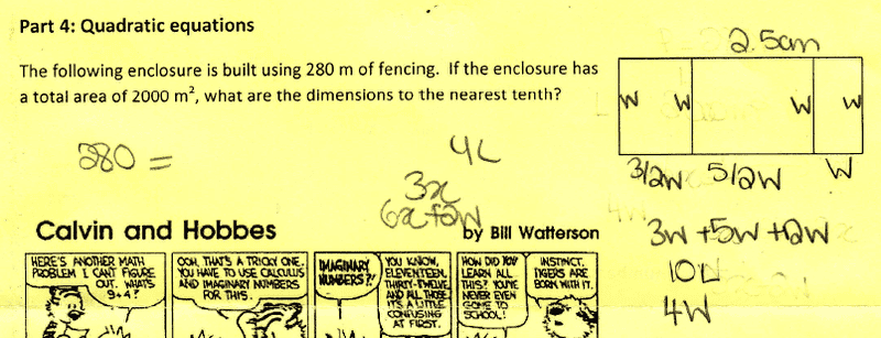

The following enclosure is built using 280 m of fencing. If the enclosure has a total area of 2800 m2, what are the dimensions to the nearest tenth?
x = [itex]\frac{-b ± \sqrt{b^{2}-4ac}}{2a}[/itex]
Please note that the 3/2w and 5/2w were measurements I did with a ruler. I am pretty sure that is wrong since this question is not suppose to require manual measurements.
Handwritten worksheet work on a scanned page: a diagram of a rectangle divided into three sections labelled w, 3/2w, 5/2w and 2.5cm, with handwritten equations 280 = 4L, 3w + 5w + 2w, 10L and 4W beside it.
Assume the enclosure is L long and W wide.
What is the amount of fencing used, in terms of W and L?
What is the area of the enclosure, in terms of W and L?
